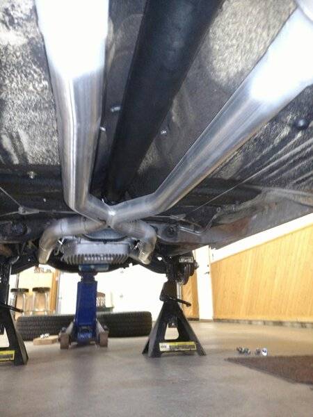

Here is a nice option if you don't want to deal with headers. Manifolds and the big 2.5" exhaust pipe all the way out the back.
Performs Nicely
That is some "Big" pipe . . .
