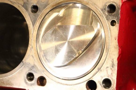

Hinkles 0.125 overbore teener Poly build
Hello Neil, good to hear from you.
We have bored several 318 teeners to 4inches without any issues.
That's a 90-thou overbore for a 402cube with a 4 inch crank.
My new idea is 110-thou overbore with turned down 340 pistons.
If it stays together I will take it out to 130-thou for some stock 340 slugs.
The Hinkles did this kind of overboring for their 426 Poly build.
They said finding a Poly 318 block was very hard so they used a Teener block.
It stayed together and made over 600 horsepower...:thumbsup::thumbsup::thumbsup:
the 318 block isnt identical to a 340 there reinforcement in the casting itself near the drivers side motor mount etc. Only thing similar between a 318 and a 340 is the crank dimensions. If Chrysler could have over bored a 318 block they would have thats why the 340 block is its own casting...I suppose its great to do it and run it down the track though if you have a machine shop with a bore machine and 318 cores there really is nothing to lose ...if it grenades tow it home try again...
