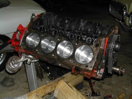

The 67-70 318 stock pistons come closest to the deck. Summit will sub them into a later model kit if requested at no extra charge.
My Demon has a warmed up 318. Engine block is 68 318 with a 73 front cover and balancer. Block deck & heads lightly planed for good seal (less than .010 removed from each). With the heads, pistons, and gaskets used, I've calculated a 9.38:1 compression ratio. It has cleaned up 302 heads and a Crane hydraulic cam 218/228 @ .050 lift. The top end consists of a Performer intake with a 625 cfm AFB. IMO it's a stout street motor with good throttle response. It wakes up around 2000 rpm which works for me.

Unless the 302s were going to be subjected to extensive work, I stuck with stock valves. I did consider going to the 360 (1.88/1.60) valves, but I never followed up on it. I had a budget number on the engine. I was a little over.
Are those pistons you mention the Federal-Mogul 1.745 compression height?
The 67-69 have a compression height of 1.759, 70-71 is 1.750, 71-86 is 1.739. These are stock pistons. The 67-69 have four valve reliefs in each piston (see photo of my 68 in the Demon). This piston sits .0036 below an un-cut stock block
You use a thin head gasket?
Yes. No problem with piston to valve clearance.
