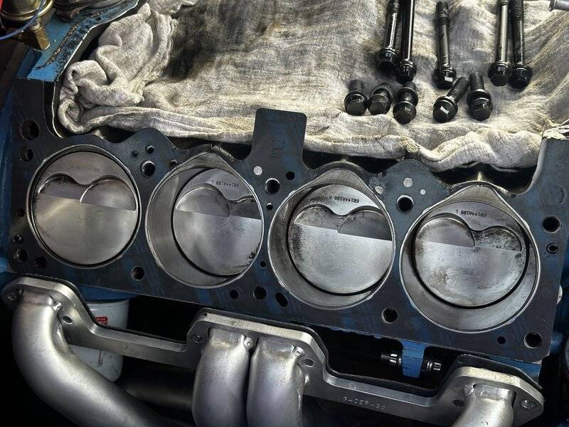

Hi, I have a few updates about how this thing turned out. I tried running this with less total advance on standard pump gas and effect was not good as you can see below ;-)
This was on 95 local which I believe is 91 American.
We didn’t give up and ordered a set of cometic mls gaskets, victor intake and decided to run 100 octane gas.

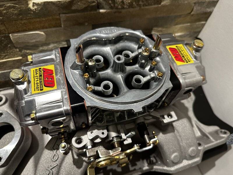

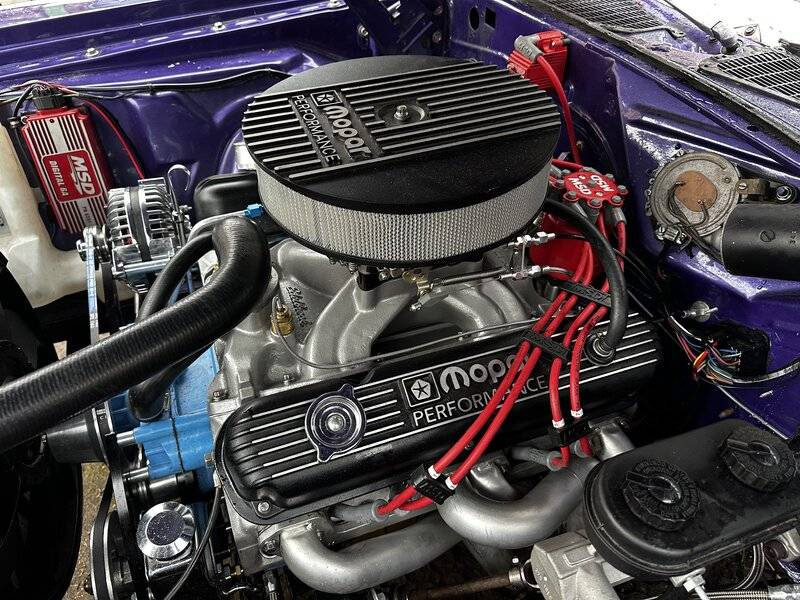

The car is absolute animal. I spent some time tuning everything but it paid off very well.
Also we got a new carb to finish this up.
Needed small jets change and accelerator pump tweak.
Here is how she runs.
Overall car exceeds expectations power wise. I opened the rings a bit to be safe with some nitrous but this will wait…

When I tried low octane fuel the advance was coming in much later and total was 30 degrees. It was all in at 4600 if I remember well. It didnt help much anyway. All it took was one hard hit.
