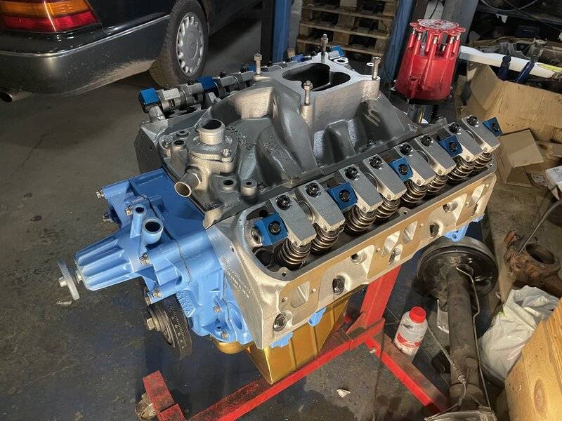

I hate this intake. I think victor would be the best for this…
This engine will evolve with time for sure.
I had a 360 with a similar set up for cam and heads.
A cleaned up victor was worth about 25HP up top but it paid the price down low. WAY behind the RPM and TQ crossover was about 5000rpm.
Yep, some don't get it: big cams & big intakes taketh from the bottom & putteth at the top.....
Guess it depends on what you are after. That 232* camshaft is almost a carbon copy of mine and it ran way better than anybody thought it would throughout the ranges with both manifolds. WAY BETTER.
My rig was 35HP better up top and from 4600 on it stretched out quickly. I looked at the sheets... I'll guess that stroker is going to be done with max HP around 5700 or so. Still going to be a solid runner with a good tune staying out of detonation.
Running a street car driving around town, I'd leave the RPM on that stroker, although, the arm would make a big difference in the lower end tq. Again, whatever you're after in the end.

I figure given almost hemi size displacement, that single plane would benefit up top, give it more rpm and make it more linear overall. That’s my view. I may be wrong.
I will work on the owner of this to switch cams and intake after 1st season of driving. That would really wake it up and take advantage of compression better.

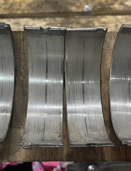

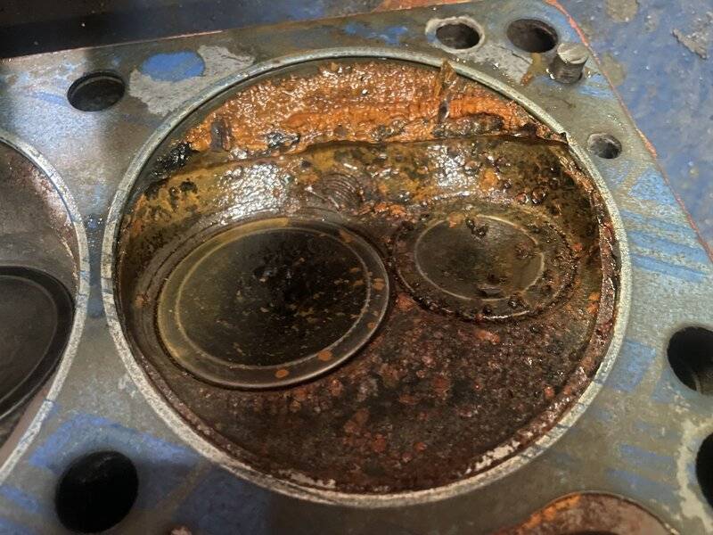

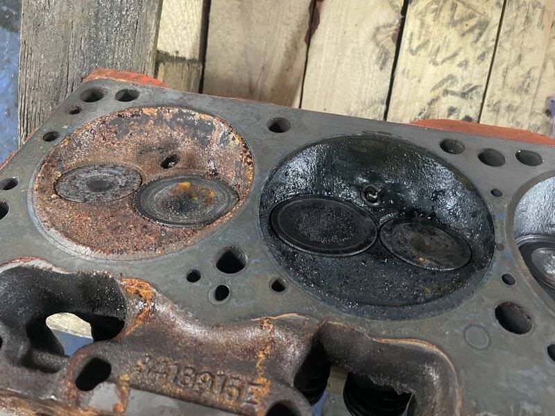

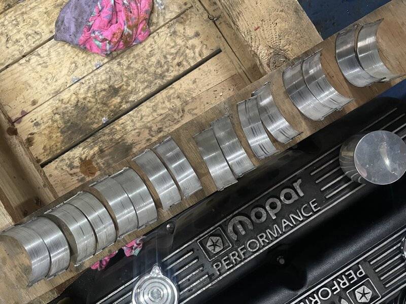

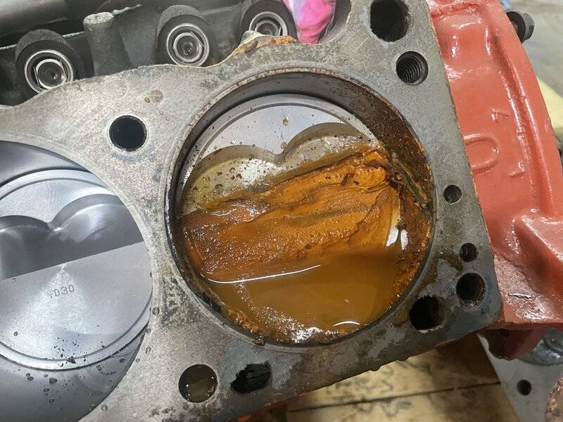

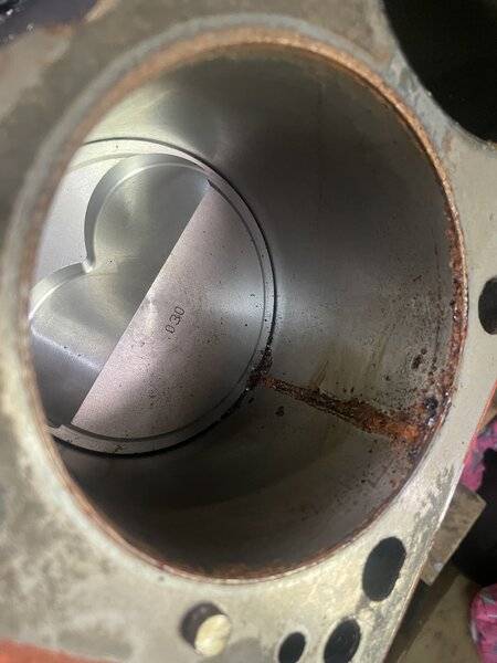

Owner bought this engine as a fully rebuilt unit. We didn’t plan any stroker kit. He wanted some good street cam and it was specked based of compression that this was supposed to have. Engine was sitting for years before I got it to check what’s inside. Unfortunately I found water damage.
Crankshaft was also useless because whoever assembled it damaged it with rod bolts. You can see “new” bearings…
Rings corroded so much that I needed to hammer out brand new pistons.

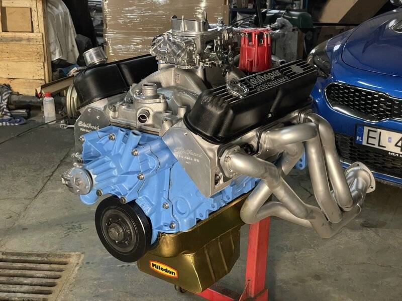

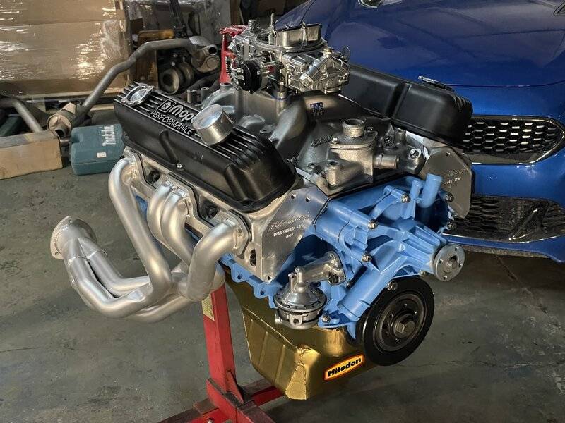

That looks awful nice. Is it just the angle of the pictures or does that oil pan sump look really far forward?
Ok I will say it, this is going into 73 Challenger with RMS suspension kit.
You guys are the best so I posted this here for opinions.
