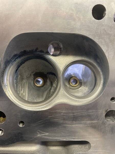

:thumbsup: could unshroud the intake a little

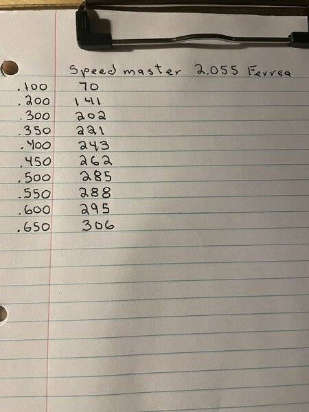

This set of Speedmaster heads really opened my eyes on a few things. He wanted zero chamber work done to keep compression up and with a 2.055 valve still put out some nice numbers. Some things make you go Hmmmm
IDK I think I would have worked that chamber and shaved the head to keep the compression up.
To each his own. lol
I’m sitting here grinding some pushrod tubes and thinking about this. Maybe I’m giving all the credit of a very stabile port to the valve job when part of the credit should go to the chamber not being unshrouded. Maybe it helped slow airspeed which these heads need badly. Hmmm
