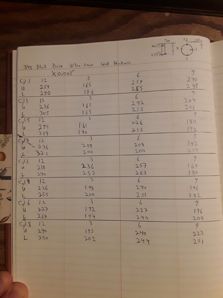

I measured my 340 block for wall thickness using an ultrasonic thickness tester I bought off of Amazon. It a cheap Chinese unit, but seems to work ok on cast iron. I dont have any delusions that this gauge will give my super accurate results, but it will at least give me an idea on thickness and core shift.
The results seem pretty good. It picked up that the thrust and anti thrust sides of the cylinders are thicker than the sides and core shift seems reasonable but it seems to be reading thicker than reality. I'm just wondering how far off my gauge is. Does anyone have experience with measured thicknesses on a stock bore 340? Based on Chrysler's literature it should be 0.140" nominally at the middle of the water jacket between the cylinders and 0.160" at the top/bottom.

I assume you have a probe with a radius on the face then? The one that came with mine is flat and about 10mm in diameter and was probably at the limit of being able to get a good reading with the 340s bore. If I measure a flat to flat and check it with a micrometer, it's usually within .010.

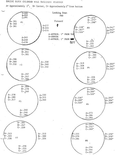

Here is a testing Lab Sonic results for one of my stock bore 360's cast 11-9-72, I include it only for reference, I have never had another test as good IMO, meaning they are out there.

My problem is with the interbore measurements with both our blocks- they are not possible in some locations. For example on your 360, #5-#7 depth B is .246 on one cyl and .247 on the other. Together that's. 0.493 worth of metal not including any core thickness. The maximum wall thickness between the bores on a 360 is 0.46 [= 4.46 (bore centers) -(2* 1/2* 4.00 bore diameter)]. That's reading .033 more metal than possible and no waterjack thickness. Same with my measurements- the sum total of the interbores come out to a number with little to no waterjack thickness possible. That leads me to think the probes are over estimating thickness a bit.

The testing lab that did my sonic check above was rather large, long established, and costly, and seemed unfazed by the requested procedure.
But I cannot dispute nor explain your math in reference to the reported figures.
Good Eye BTW.
