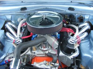

Well, zing.
This is the very first start of my rebuilt 360 pulled from a 1974 Dodge D100. It has a 0.030 over bore, 340 cop heads, 1.88" embiggened valves, Weiand Stealth intake, hydraulic lifters and cam (260/260 Comp cam), Edelbrock performer carb, MP electronic ignition kit, and Denso alternator. Only the passenger side exhaust is hooked up because the larger oil pan interferes with the driver's side exhaust hookup. I'll need to get the pipe extended a bit. The radiator is original but modified into a 3-core unit and relocated ports to accommodate the later style aluminum water pump. The exhaust manifolds are original from the 273 except that I had them Jet-Hot coated.
I repainted the engine a Porsche orange. I had a ton of POR15 orange engine paint laying around and it falls somewhere between Chevy orange and earlier Mopar orange. I didn't really dig the hemi orange color very much and I wasn't certain which orange to paint it, but this orange is beautiful. All the accessories, brackets, and what-not are powder coated satin black. Every last fastener, nut, bolt, and washer has been replaced with stainless or grade-8 fasteners. The bay is painted with Valspar tractor paint in satin black. Eventually I want to paint the car some other color, so I chose neutral black because it would go with anything.
The bay looks dusty because I've done all the work under a tarp so much of the yard has blown itself into the bay. I can't wait to clean it up. Only the hydraulic clutch pedal setup and brakes remain to be done.
