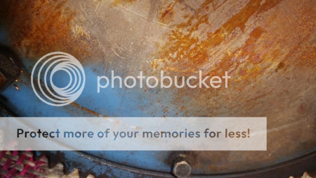

Now this is where I need a bit of help. I have searched all over for the answer and I must not be asking the right question. I know it's in here somewhere I just can't find it. Is this an external balanced torque converter?

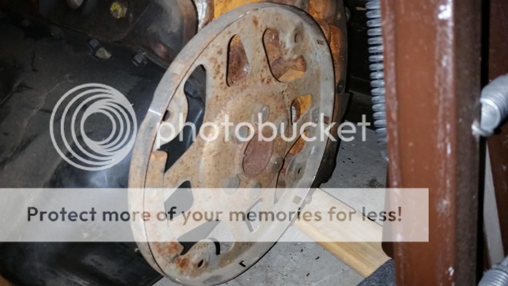

I also have this flex plate. on a junk 360 magnum I picked up.
So what do I need ?

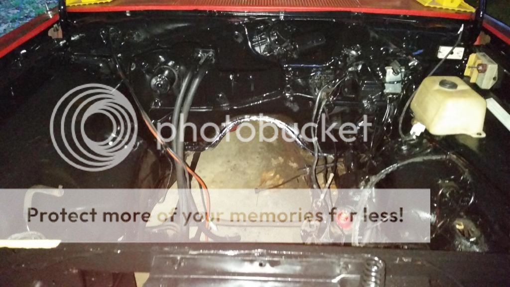

I love this place by the way. I have had so many questions answered here. Oh yea this will be the heart to this. My 73 dart swinger.
This is also my first build on a car. I have been wrenching out of necessity all my life. This I am doing for fun.
The converter is NON-WEIGHTED. Chyrsler weights welded to the front (pilot side) cover of the converter. Are their any part numbers on the converter, or any tags? It looks like it might be a rebuilt unit as the factory doesn't paint converters. As it has a narrow ring gear on it, it's a 12" unit. Any idea what the transmission came out of and what year it is?
That's about all I can tell you from the photos.
The trick here is to use a neutral balanced converter( no visible attached welded weights),and a 97 on up counter weighted Magnum 5.9 flex plate. (the picture you show of the flex plate, looks like a counter weight at 9 o'clock.Not positive for sure, without looking at mine). Once that's sorted out, match up the torque converter bolts. You probably will need to offset one,quite common.

Looks like the only thing is a "C" ? Stamped on the front side. The paint looks like over spray.
The transmission has the partial throttle kick-down. If that helps.
As long as there are no visible welded weights,you should be good. I would take the time now,match the converter pilot hub & torque converter measurements, make sure they fit now. Not much luck on identifying stock converters,without a ATRA catalog.Post 2 is you're guy......
Good information here^^^....
So you know a counter weighted converter when you see one here's a picture. As you'll see they place the balance weight (for the engine) on the front side of the converter. There may also be a thin strip or 2 of steel around the outer perimeter of the converter to balance the converter itself but they have nothing to do with balancing the engine. Your picture of your converter shows one at approx. 10-11 O'clock

This is what I was looking for. The flex plate does look like it is weighted. I will check and adjust fitment today. Thank you gentlemen.
I am in good shape Gentlemen ! Thanks ! This issue was one of the biggies I was facing.

Do you have any idea what year the transmission is, and as Bob mentioned don't remove that weight as it is the weight for converter balance.
Also, look closely at the hub of the converter. It must be mirror smooth, just like a crank journal or you'er looking at trouble. You can rip the seal, or worse damage the front pump bushing.
Typically, most stickers, or numbers use to help identify Chrysler converters are on the pump half (the half with the hub) of the converter.
I picked up on that balance the converter then the balance of the 360 aspect. I won't remove the weight.
