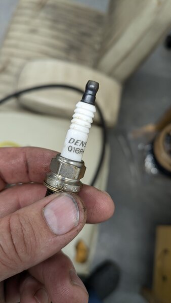

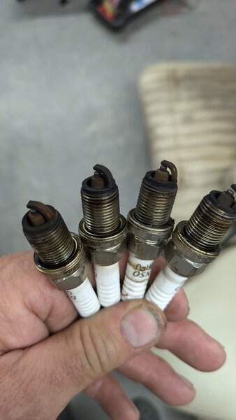

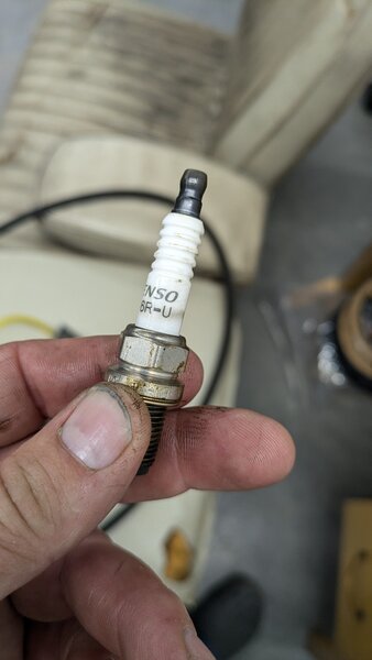

Well I got it back together and it runs so rich at idle I need to pull the PCV vacuum hose off to get it to idle.
Off idle sounds great, idle sucks donkey balls.
I put everything in the sonic cleaner when it was apart to clean them then blew out all the passages unless the idle one I need to remove pressed in plugs?
What I actually meant in post #8 but wrote it badly....is that for several decades Holley carbs worked fine with non-removable air bleeds....
Can you kill it by screwing the idle mixture screws all the way in? Does it respond at all to changes to the mixture screws? Barely snug. If not, it’s getting fuel from somewhere else. Float level? What is the fuel pressure? Is fuel dripping out of the boosters? Dripping out of the accelerator nozzles? Is it a two or four corner idle mixture screws?
It runs fairly well other than being rich, idle is really bad burns your eyes out in a matter of minutes even with the garage doors open.

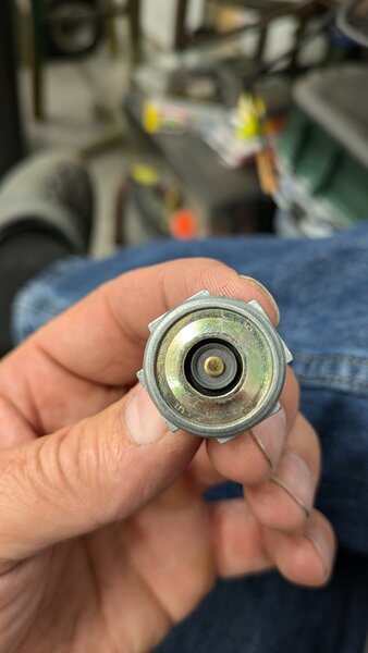

Sounds like the PV gasket isn’t properly seated, allowing some fuel to leak by.
