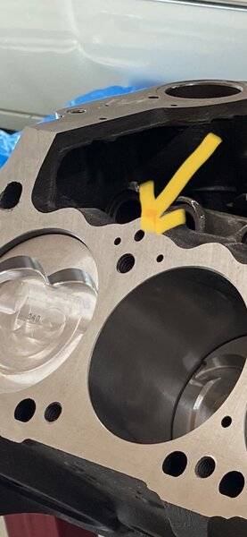

Can you post pictures of the deck surfaces. Be interesting to see if you got an early Magnum or later.
This is what you want to look for on both banks, between cyl 1-3 and 6-8. Oil passages drilled. Early Magnums have the passages drilled. At some point they were no longer drilled, hard to pin down exactly when that occurred. But just because it’s a Magnum block does not mean it’s not drilled. You may luck out, and will then have more options for rocker arm assemblies.
With the TF heads and those rockers you should oil through the pushrods. Same combo I used with a early la block. If your block has the oiling holes you can can do several things. I chose to tap and plug them. You will need to get a push rod measuring tool to determine pushrod length.
