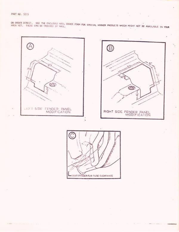

A little hard to read but you can blow it up a little ..... in case anyone needs

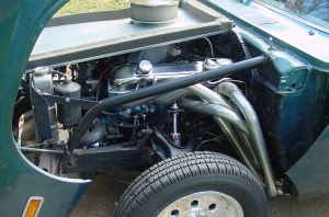

Scroll down about half way on this page, and you can see where I cut the headers to make more room for the front tires. Further in the thread there may be pictures of the headers from the top so you can see the clearance from the tube to the MC.
