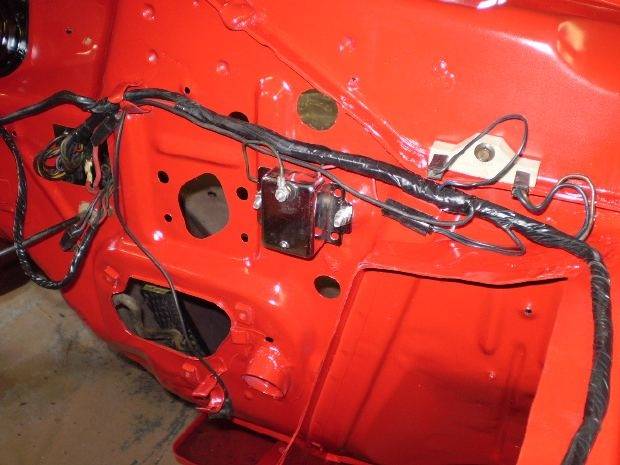

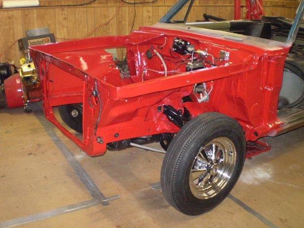

Hi Guys,

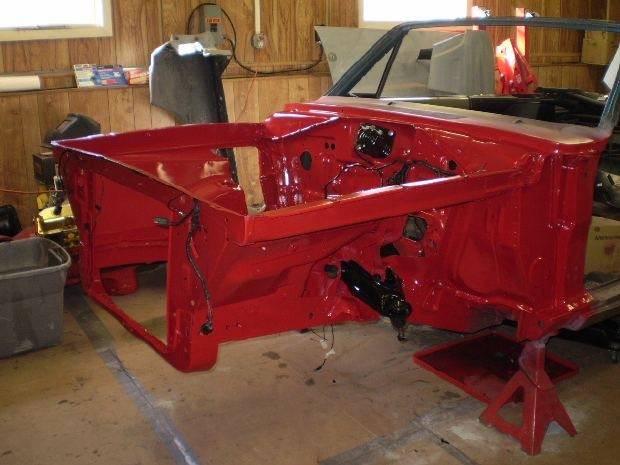

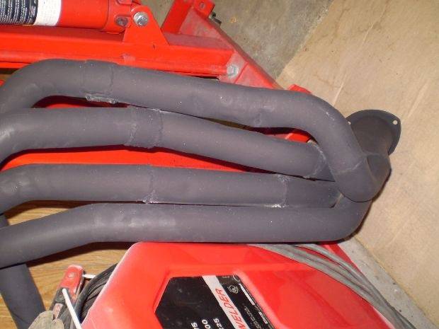

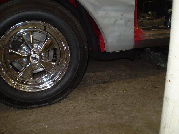

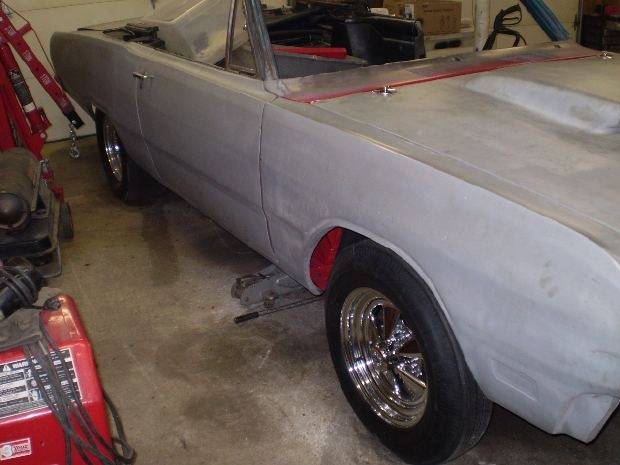

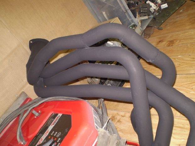

I know I should have started this as soon as I bought the heap, but I didn't. :D Anyway, it's a 69 Dart convertible with a 440 and 4 speed, 8-3/4 Suregrip with 456's and Super Stock springs moved inboard, fenderwell headers, hydraulic clutch, fiberglass nose with lift-off 6PAK hood, large bolt pattern disc brakes and a power top. Interior will be black and so will the soft top, rear stripe, and the hood. I have a set of front 15X4 Cragar S/S wheels and skinny bias ply tires in just got from Wheel Vintiques. Might run a set of 15X8 steelies out back, but undecided as of now. You know how I am with Cragars!

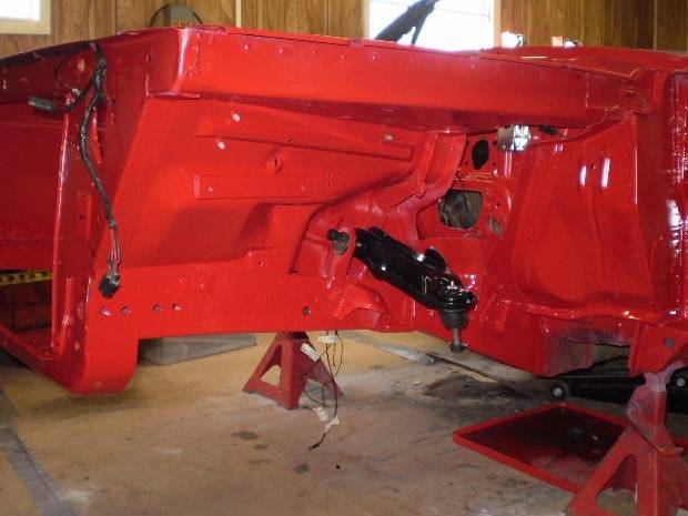

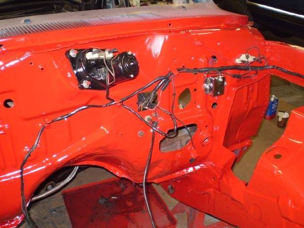

Just got the engine compartment ready for paint on Friday so I threw some red enamel in there so I can put some stuff back ON the car for a change.
I sold my (Avatar pic) gold 69 Swinger 340 in October, and we dragged this thing home from New Jersey on a trailer. I only drove it off the trailer and into the garage, and never even drove it around the neighborhood.
Those of you that followed my 340 Swinger resto may be disappointed with the lack of detail on this car, but I simply can't do that level of restoration work again right now. It's too expensive and it takes too much time. I want to drive this one this summer. LOL
Figured I'd show you guys where I'm at right now. FEEL FREE to make suggestions as you see fit! I encourage them.

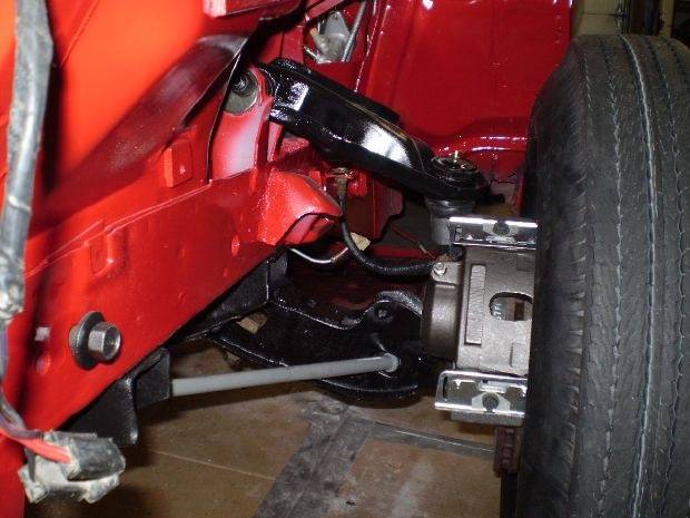

Car will have 1" torsion bars that I picked up from the fire sale Joe posted. Thanks again Joe!
Anyway, here it is!!!!
George

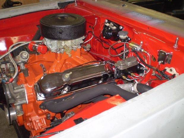

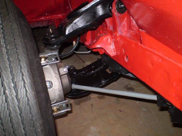

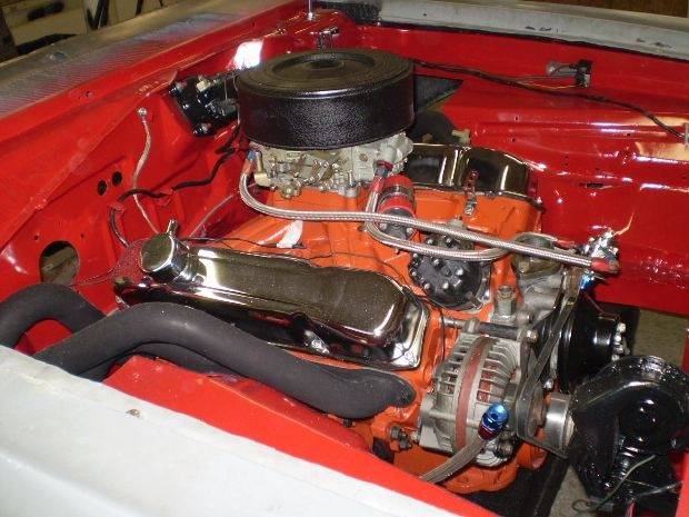

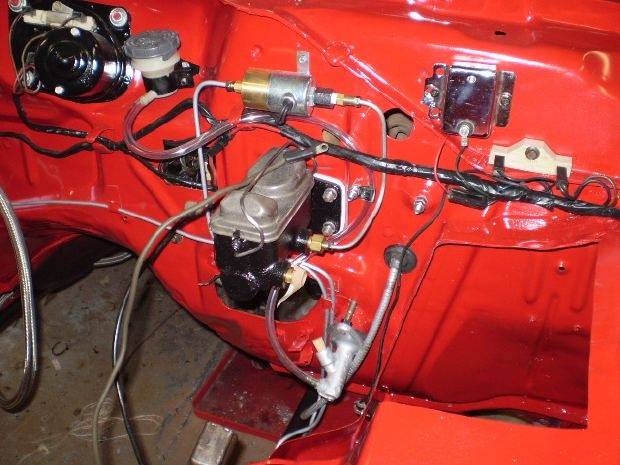

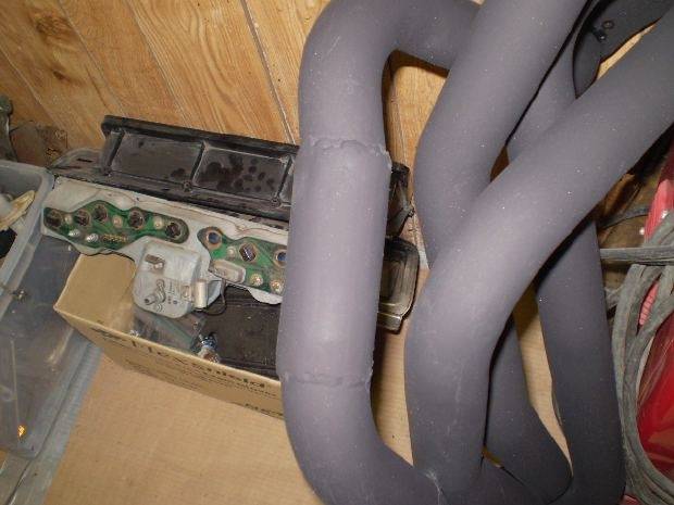

Made a little more progress. Hopefully I can regasket and paint the 440 this weekend, and drop it back in the car.
Note new brake lines, Line-Loc solenoid, hydraulic clutch cylinder, new brakes, bushings and modified fenderwells so I can turn the car.
George

Hydraulic Clutch? Very Cool.
Whats The Solenoid Above The Master???

Things are looking good, George. Keep up the good work. What hydraulic clutch system are you using?
Solenoid is for the Line-Loc.
Hydraulic clutch parts were with the car when I bought it. I just had to reengineer the system so it would be more comfortable and work properly. Its a 5/8" bore master and a 7/8" bore slave. Steel line connects the two, and there is a remote reservoir. The parts look to be generic stock parts from a newer truck, maybe? It has a 5" pedal travel and a very light pedal pressure.

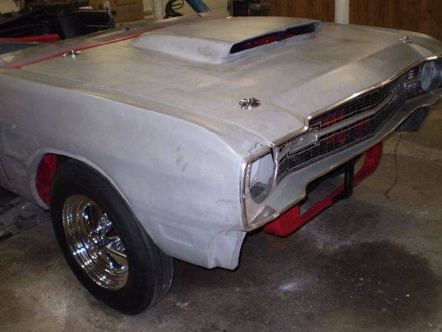

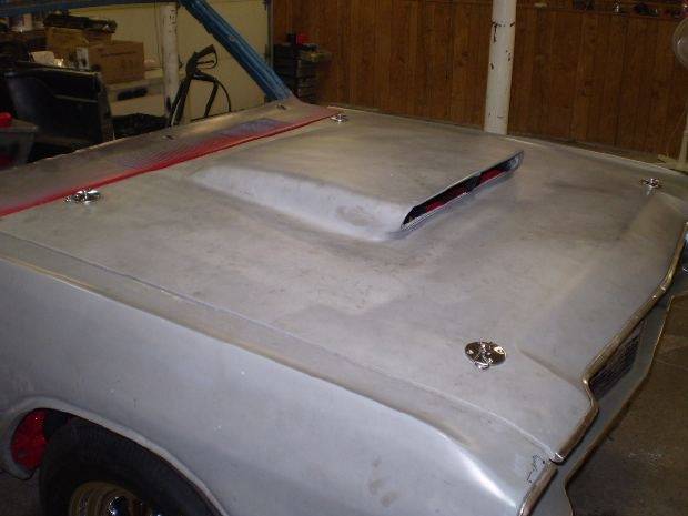

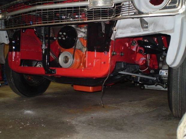

Here are the latest pix from this afternoon. I was fitting up the front fiberglass and grill so I can get them ready for prep & paint. It looks like I'll be painting this car in sections (I've done it before, no biggie) rather than as a unit. I just don't have that amount of time like I had with the gold car. This one doesn't have to be as pretty, though! LOL
George
