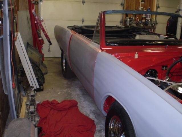

Finally got something to take a pic of.....
Quarter and door ready for hi-build primer.

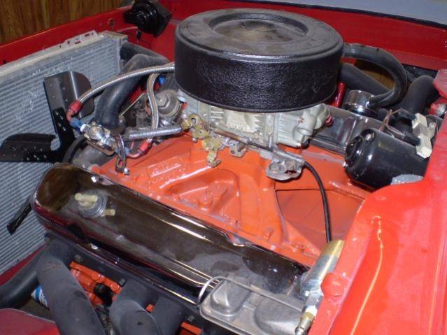

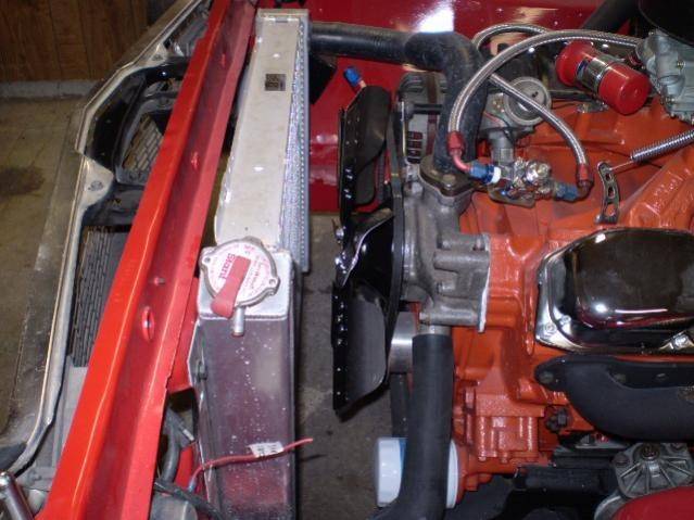

Clutch and brakes bled, and throttle hooked up, Hurst Comp shifter installed and adjusted, and the flex fan installed. Just bought a plastic shroud off eBarf from a /6 car. Should fit like a glove.

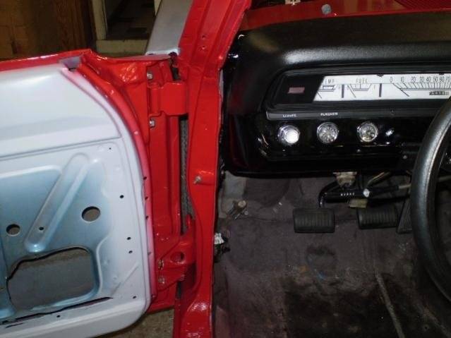

Hey George, I love the dash! Looks like you will be driving soon. Can't wait to see it on the road. That car is going to screeeeem!!! Not much going on here... just ordered the headlight switch and installed a new tach. The dimmer portion of the switch gave out. The copper wiper arm of the switch that contacts the rheostat coil had built up a hard film that actually insulated it. I could have sanded it off and reinstalled it but I decided to replace it instead with a new original after 41 years. Your car looks great!

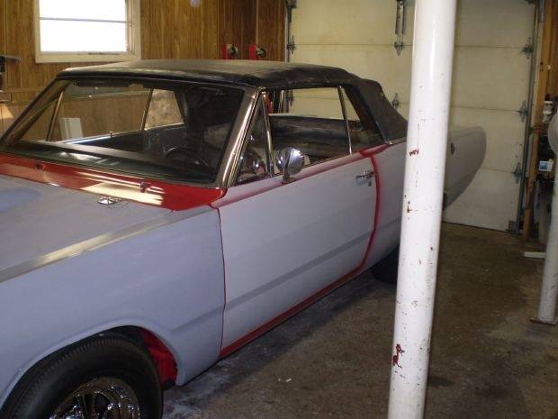

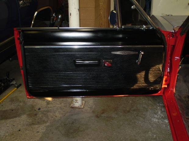

Got the car turned around under it's own power. Got the top back up, and backed it in the garage so I can get to the pass side.

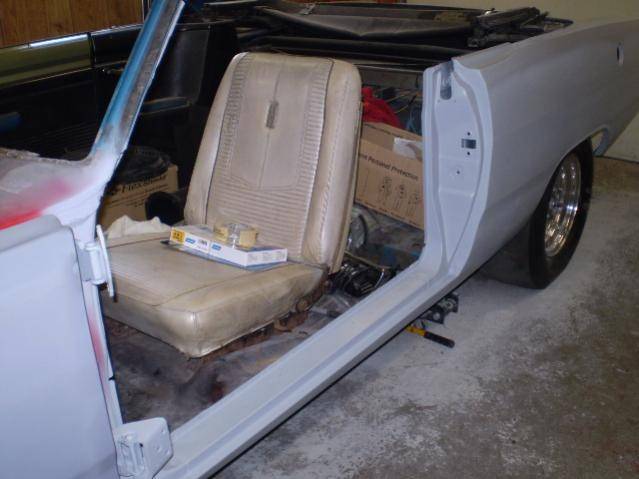

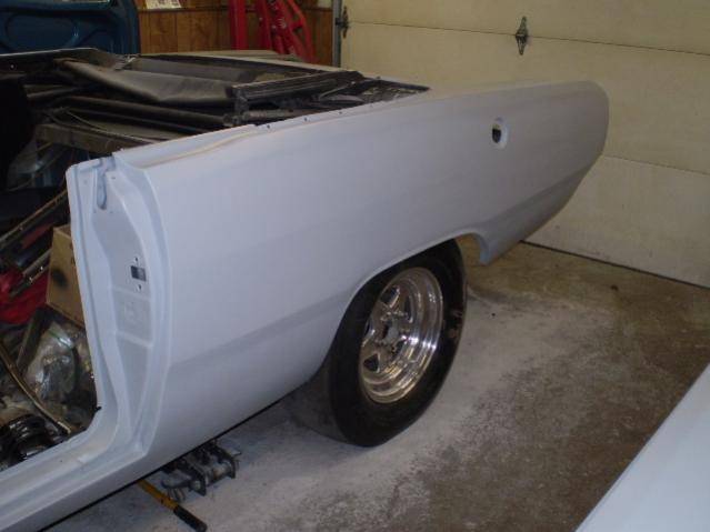

Here are a few pix from last evening. Getting closer to driving it. I'm going to drive it in primer this summer and do the bodywork over the winter.
Still have one PITA job to do that I'm NOT looking forward to; build an exhaust system. LOL
Anyway, here is where we're at...............
