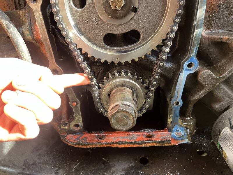

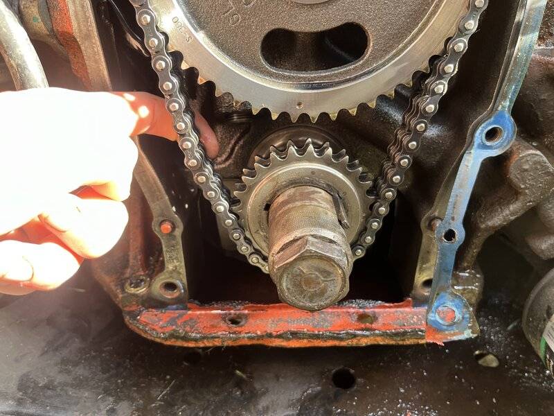

okay got it all apart, now just waiting on the mail man to pick up his pace ha. for reference in the pictures the chain has 1/2 in slack side to side from where my finger is at. am i the only one who feels like this is a lot for a new timing set? (comp cams double roller single bolt chain set)
also the dots are not lined up in the pic i know. i turned it a little after the pictures were taken and lined them up

check out the pics i posted in this thread of the chain slack and let me know what you think. i wasn't sure how to tag anybody in my response lol

For new? Yes. That does seem alittle loose. That's typical of older setup.
At least what I've seen. Not to say it's of every case.

yeah for a new set from what i've read it's a bit loose. people say 1/2 deflection is the point of replacement. that can't be the total loss of power though because it is probably only a couple degrees of movement. hoping the timing kit is out of degree. after work today i'll pull the intake and plugs and check the cam. answers will be given soon!

Make double sure you get top dead center on piston or any numbers you come up with are wrong

yeah i'll probably verify it a couple times the kit i got comes with a piston stop so i'll just mess with it until i get consistent readings. i also bought a single solid lifter because from my understanding it makes it a lot easier to degree and get consistent readings with a solid lifter installed
I would degree the cam with a degree wheel, if at all possible, even if you install another timing chain set. Plenty of instructional videos on the web to help you along. I once installed a big name brand double roller chain in an LA smallblock I was building. If I hadn't degreed the cam, I wouldn't have seen how retarded the timing chain set was right out of the box. I verified multiple times and kept coming up with the same numbers. I don't know if it was a manufacturing defect, or what, but the replacement chain was spot on. If I used the defective timing set, I would have had a horrible running engine, if it ran at all. With a 4.56 gear, you should have plenty of pull in 3rd gear if everything is right.
In your mind, have you skipped ahead to what you’ll check next…….if the cam timing isn’t way off?
While the loose chain isn’t at all optimal…….that by itself isn’t the cause of the missing 1+ second ET.
The solid lifter……:thumbsup:

The other thing is a way to move the timing just one or two degrees, offset dowel bushings are nice, the top gear is drilled out on dowel hole to adjust either way. Stick the appropriate offset that’s needed, might have to do again (they’re color coded for degree. You doing great, confidence is your friend!
