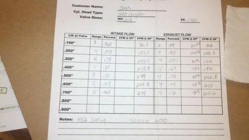

this should answer alot of questions. I took these down today to have flowed. Here is the sheet.

Like I said, they ain't stock.
Yeah he first said they dont look ported at all. And said id be waisting my money if I flowed them. I told him to go ahead and do it anyways 70 miles down there i didnt go for nothing. Then he came out and said they surprised him. Said the exhaust flowing like it does is really good.
Interesting between 400 and 600. I'd love to se a reading from .550... because the increase seems to plateau, then somewhere between .500 and .600 picks up again. If I was camming for these heads, I'd be looking to either stay below .500, or go above .600. They are a decent head, and much imporved over stock (yes, the exh #s are good), but it's a wierd step in the flow curve right where I wouldn't want it.
.600 lift might be too much for a street car. But thanks for the input. Im tickled to death right now. Not bad for $200 investment.
