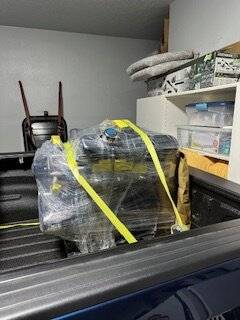

Update - Engine is going to Koffel's tomorrow morning, so actual numbers will be available this week.

I hear what you are saying. I have found other ported SR heads that flowed about the same as the sheet says online. At the end of the day, the ports look great on these heads and we will see what the dyno says. I dropped it off at Koffel's this morning.

Just a couple updates. Scott Koffel and I talked this morning when I dropped off the motor. He seems to be easy to deal with and knows what he is talking about. That being said, I am more concerned than ever about the hydraulic roller lifters. Mine are Trickflows purchased on 2021, so I believe are actually Morels. Scott relayed that they have had issues with hydraulic roller lifters on the dyno, but not the instability issues that others have mentioned. Basically lifter plunges getting stuck due mainly to tolerance issues with the lifters. He said this was mainly with comp hydraulic roller lifters, so I am keeping my fingers crossed that I won't have this issue. Motor should be ready for some pulls tomorrow.
