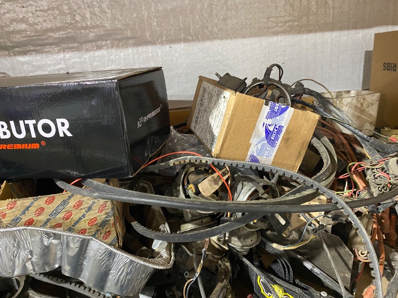

I believe I still have one sitting on the shelf. If you need something to test with I'll take a look. and message you. It's free, to anyone who needs it. Just cover shipping.
I'll take it, thank you! 06370
Correct. OE Lean Burn distributors are a nice simple locked advance with a magnetic pickup (vr sensor). Pretty easy to use with EFI.
the ones i see have vacuum advances so those aren't the one you'd want for this application
I thought he was looking for the dual pick up unit. Unfortunately it may have got tossed. It came from an 86~ 360 truck engine I sourced.
You can use the single or dual pick up Lean Burn although aftermarket EFI will use only one of the pick ups.
