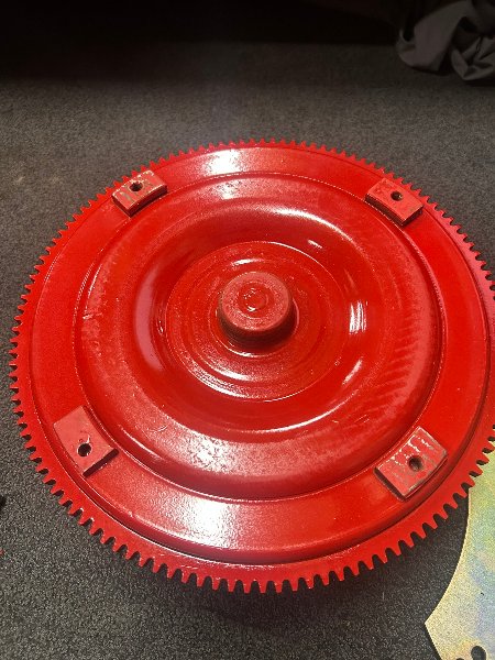

I just bought a Hughes for my 904. The flex plate mounting holes won't match up. Impossible to get all four bolts in. The problem area is the mounting pad that has the hole off to the side. I don't know a whole lot about torque converters, but it looks to me as if that pad is from another converter.

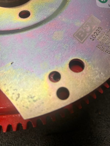

Well yes for proper clocking of the flex plate. But what I'm saying is the holes are "off" making it so the flex plate can't be bolted to it.

pfft! don't ya know, you're supposed to get a file and elongate the hole on your new $200 flexplate, dummy!
(hughes converters, probably)
[judges would have also accepted: well, looks like B&M made your flexplate wrong then]
Yeah and I garranDANGtee you that's what Hughes would tall you to do. Morons.
