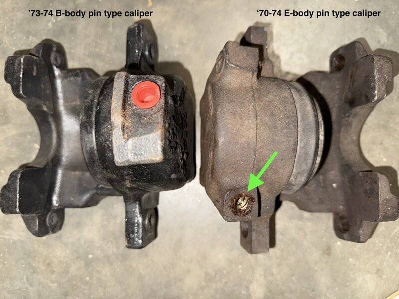

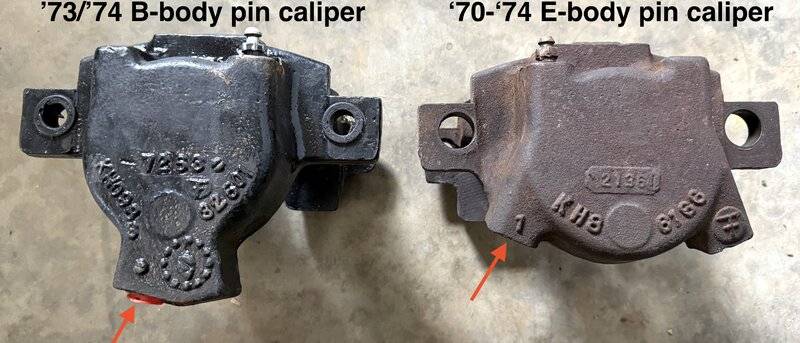

The lower control arm shouldn't change anything relevant to the caliper clearance.
I believe the only calipers that have that bottom outlet were the '73/74 B bodies, everything else should have them somewhere else. But RockAuto's pictures may not show that, you can't necessarily count on their stock photo's matching the exact part number. E-body calipers have the offset hose location, as do earlier B-bodies and some FMJ's I believe.
img_8449-jpg.1716345767
And to be clear, it's not just a hose outlet difference. The body of the caliper itself is different, the '73/74 B-body calipers have a large protrusion on the bottom of the caliper that isn't there on the E-body calipers. You can't see it so much in the top picture, but this one makes it really clear...
I had heard of this issue before, but I ran into it myself a few years ago when I was installing 73+ disks on a buddy's car. I don't recall exactly what it was that the '73/74 B body caliper interferes with, but I know that there was nothing I had on hand (different brake lines) that could solve the issue. And to tie into the whole part number thing, the remanufactured calipers I had were supposed to be a set, but I had one of each kind.
There may be a hose line solution, but IIRC the issue is less about the hose line and more about the shape of the caliper itself.

Yup, mine look just like the 73-74 B calipers in your picture.
I'll put it all together with what I have and go from there. I don't have any Pin on style 70-74 E-Body Calipers.
Maybe a buddy of mine here local does. I'll check with him.
In the meantime I ordered a pair of decently long stainless Brake hoses with 7/16 banjo
They were Amazon "Like New" used and only $16 plus still have free return... Same ones new were ~$65
So I figured worth a shot.

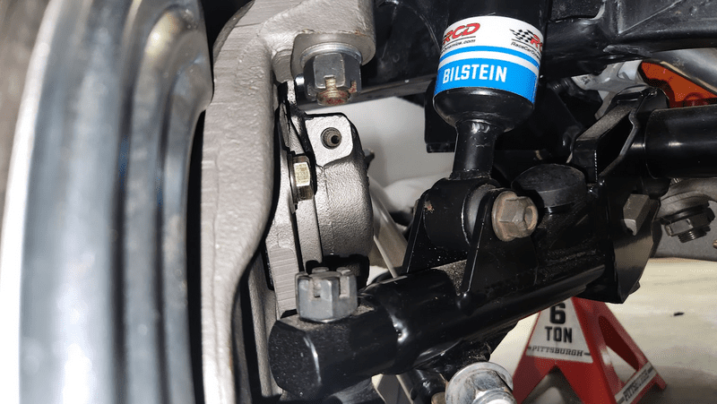

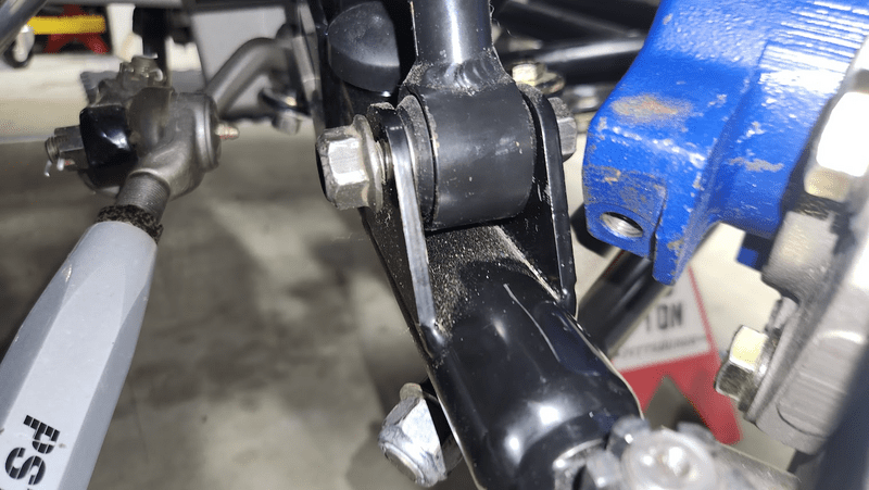

Ordered a pair of E-Body calipers from Rock Auto, since the ones I had were not going to work.
I had the calipers Rear Mounted and then switched them to Front Mounted and both ways were No-Go.
Inlets would not have room to connect the brake hoses.
QA1 K-Member, QA1 LCA.
Straight or Banjo, neither was going to clear the shock mount.
Closer than it looks here and it looks close. Passenger side with B-Body Caliper Front Mounted.
Plenty of clearance on the Driver's side with an E-Body caliper Front Mounted.
Just need to figure out what Brake Hose Part Number to order.
Need a straight one that just threads into the caliper end.
A length of rigid line 2-3 inches would be good, then the rest hose. 16" looks about right.
Any of you running Pin On E-Body Calipers, front mounted? Can you recommend a Brake Hose that works?

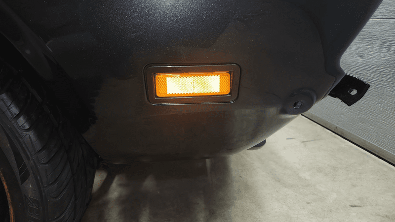

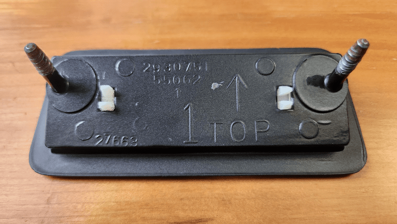

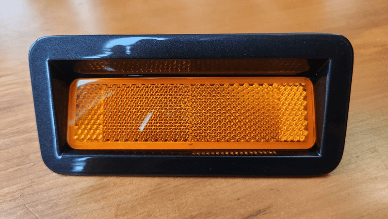

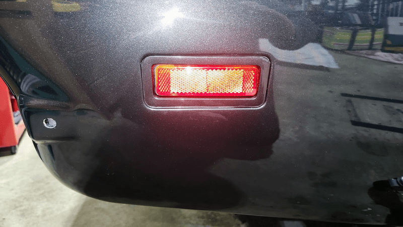

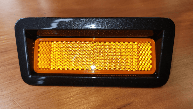

I finally got my front side marker bezels back from my painter...
So they are now on the car. Can check something off my list finally. Woo hoo.
Fronts are not reproduced and are different from the rears. Good ones can be hard to find.
I ended up with 3 pairs, these being the best ones.
Back side with the PN
The Rear.
I thought about making them lights, played around with some LED's and my old reflectors and mocked up a pair. Then decided not to... Reflectors are low maintenance.
This brake hose is about the right length, 16", but need the caliper end to be threaded to screw direct into the caliper inlet without a banjo.
View attachment 1716377228View attachment 1716377229
The Rear.

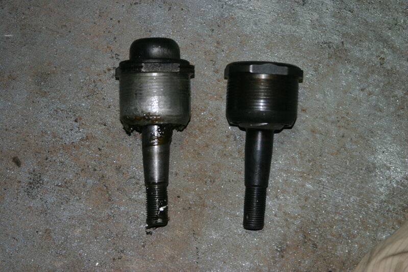

It is just standard '73-'76 A-body Upper Ball Joint from Moog.
I don't know who made the one on the left, but with the dome it would not clear a 17" wheel.
You may already have the correct type on the right.
Once you are "over" the ball joint your limit becomes the outer tie rod (OTR). So perfect offset on 17" is what leaves you a little clearance on the OTR.

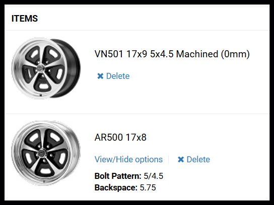

Back to looking at these American Racing wheels again...
When ordering from Wheels for Less Reseller, they offer the "VN501" off the shelf Mono-cast 1 Piece with zero offset $, Budget friendlier...
They also sell the "AR500" a Custom 2 Piece with choice of Color, Bolt Pattern and Custom offset $$$$
Same style wheels low cost one piece cast and more expensive custom two piece...
Standard finish is Black/Machined I would order them all Matte Black as in the picture above.
*Edit, 17x9 for the rear, 17x8 for the front.

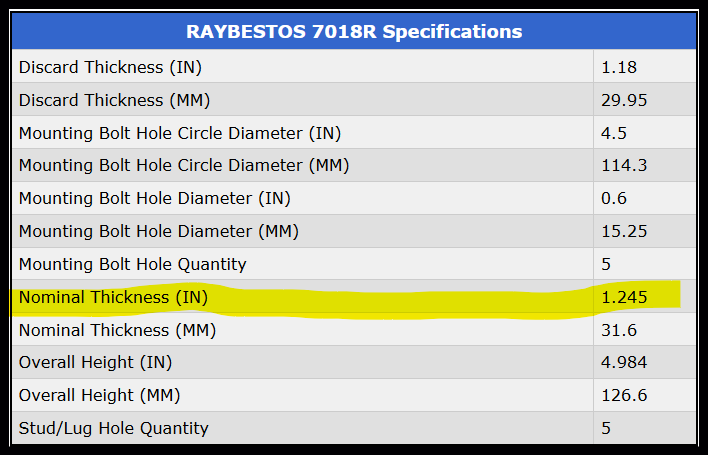

The 73 C-Body, New Yorker 11.75" rotor is 1.245" thick but the rotor overall height is .27" shorter than the standard 1" thick rotors. That is they give a narrower track by .27" per side.
So with my 73 C-Body (New Yorker Rotors), I should be able to run a 5.25" Backspace... or 5.5" BS and add spacers to move outward as needed to clear the OTR.
Much easier adjust outward by adding spacers to move the wheel out if needed.
73 New Yorker Rotor specs, thicker rotor but moves the wheel mounting surface inward by .27"
Cordoba Rotor specs

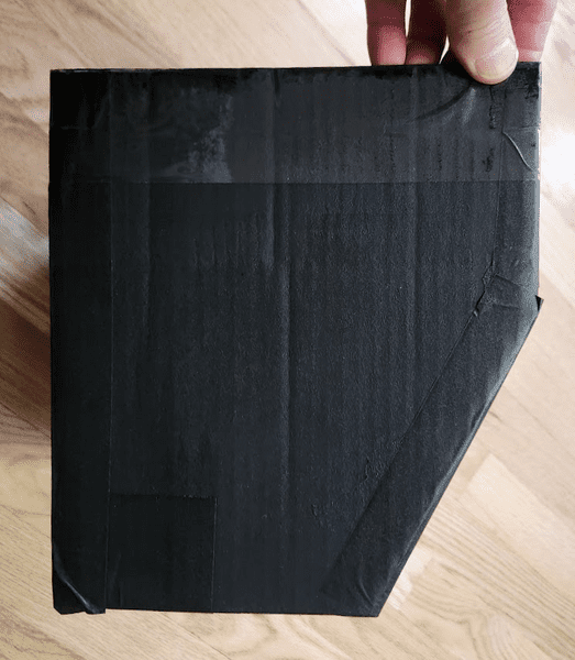

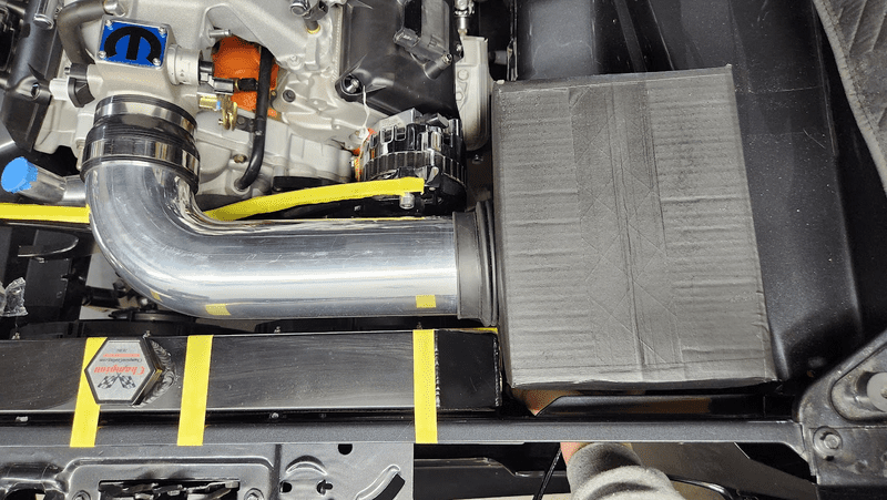

In the meantime I spent a little time with some trial and error on a DIY Cold Air Intake.
Started with a couple versions of just heat shields but then decided to do a sealed box but without too many angles.
I'm pretty happy with this version mockup. The final will be either ABS or Sheetmetal, haven't decided yet. I have some sheet ABS so I'll try that first. Don't want a shiny aluminum tube, so it will be sanded and painted or powder coated wrinkle black. Need to drill for the MAF port first. The ABS sheet material I have has one side textured so will see if I like it before seeking to build one from Sheetmetal.

The Box will have a 4" inlet and 4" outlet, the air tube is 4" OD, my BBK Throttle body inlet is ~3.5" OD.
There is a just over 4" hole through the massive USCT core support (Supports my 26" Champion Radiator), I will connect the Core Support to the Air Box with a rubber or silicone connection, so it stays sealed and isolated from engine heat.
The air box is about 10-5/8" x 8.5" rectangle on top but the driver's side tapers inwards away from the inner fender. the bottom sits just above the drain hole that would be for the battery tray but I will use it to pass an airbox drain of of the engine bay.
The filter is pretty big, it has a 6" opening and is over 7" long.
The filter outlet uses an offset 6" to 4" reducer which makes it possible to mount near the top of the box.

Stole this pic off the interwebs... just to eyeball the path of airflow. Picture angles are a little different but gives a good idea of the location behind the grill.
Should get some pretty good airflow through this location. Could extend the box inlet to the back of the grill but not going to worry too much about that for now. More on my to do list ahead of that. Not going to be a lot of space between the egg crate/parking light bracket assembly and the core support.

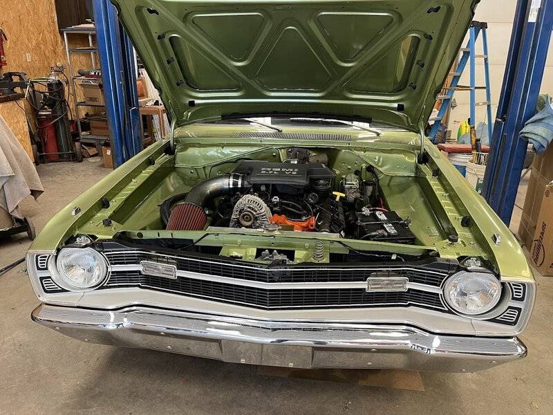

Making progress with my DIY CAI

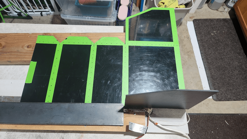

Laid out my cardboard Airbox model and transferred the measurements to a sheet of1/8" thick Black Textured ABS plastic.
Thought about how I wanted to make the corners and decided to create Tabs that would bend and be inside the box to attach them to the adjacent sidewalls after forming the box.
Once I was happy with the layout, I used a piece of flat bar steel as a cutting guide and to clamp down and hold my plastic as I cut it out with a Dremel plastic cutting disc. Keeping the Airbox plastic under the bar stock as a guide helped to keep my lines nice and straight and any slips would be into the waste material.
Set up here for my first cut.
Just happened to work out with the 2 longest straight pieces landed on factory edges.
Here it is all cut out.
I made a sheet bender with some scrap pieces of wood, a heat strip, some aluminum foil and some aluminum heat duct tape.
Figured out the order to make my bends without blocking any of the next bends... and started heating and bending. Here is the first bend. Then heating 3 tabs that need to fit inside the box, so these needed to shift inward a little bit. This is where there is a bit of guesswork... No directions included...
Next side...
After making all the bends and some gorilla tape to hold it together. Not too bad...
Cut a hole for the filter and test the fit. It's Good!

Thanks again Michael! My upper ball joints do not have the Bump.
Cordoba Rotor specs
- Randy

9’s up front realistically means 18’s or extensive fender work.
17x9 +0 won’t cut it. A 9” wheel up front realistically needs almost 6” of backspace to clear the fender (on a 73+ set up), a +0 is only 5” so even if you’ve got an extra 1/4” vs a standard 73+ set up that’s still no where near enough.
The problem is this- you still have the same clearance issue to the outer tie rod. Typically that’s an issue at around 5.6” of backspace with a 17”, for you that means it’s gonna be an issue at around 5.35”. So yeah, the 17x9 +0 for you is like an effective 5.25” of backspace compared to a 73+ brake set up, but you’d still realistically need close 5.75” to make the wheel actually fit in the fender, but that won’t clear the tie rod.
Like @mosleyme said, you have 17x8 +0’s on there now, your best bet is to measure the distance you’ve got from the outer tie rod end to your current wheel and take most of that distance and add it to the backspace of your current wheel to figure what you want on the next set.
And think about it this way, 17x9 +0’s will stick out an extra 1/2” compared to your current 17x8 +0’s. Centerline is the same, wheel lip moves out a 1/2” on both sides.
Doh! my bad, should have said, off the shelf one piece 17x9 5" BS would be for the rears...
I know those fit, same as what's on there now.
The Custom 2 piece 17x8 with custom BS, 5.25, 5.5, 5.75 etc. can be ordered and would be for the fronts.
I'll put the Year One 17x8s back on and measure wheel clearance to the OTR end.
Won't be exact because no front end alignment on the car, everything is just bolted together out of the box.
Eyeballed for everything and the torsion bars cranked up to keep the tires from hitting the fender lips.
It should give me some idea how much further back I can go though.
I'll measure clearance with the standard 11.75" rotors too. I'd be okay with going with the BS to fit the standard rotor and a spacer to use the same wheel with the 73 C-Body rotor...
Measure actual backspace of my 17x8s
Measure clearance to OTR end
17x8 BS + clearance to OTR = new wheel BS
Can always add minimal spacer if I end up too close to the otr after alignment.
The alignment will not change the outer tie rod location vs the wheel. That is fixed by the geometry of the spindle and lower ball joint.
After setting ride height, the OTR has a full 1" clearance but the closest is the SPC UCA at about 5/8"-3/4" from side to side...
Set the car to ride height by lowering the tension of the TBs and bouncing the front up and down.
Then checking the range of motion again... nothing rubbed. Scratching my head now... didn't touch anywhere.
Still the closest point was the lower front fender but there was an 1/8" or so of daylight...
Taking all of the tension off the TBs allowed the tire to go up past the fender lip without hitting... straight or turning... Not the same as real world driving so...
Going to stop right there for now. Want to get to the point where I can get it running before changing anything else with regards to wheels and tires.

Shaved .3" off the back of the Year One Wheels = actual measured Backspace is 4-5/8" now.
73 C-Body Rotor gains equivalent + .27" positive offset = 4.895" Call it 4.9"...
1/8" daylight clearing the lower front fender corner at ride height.
