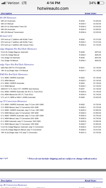

I am pretty sure that MMX gets the ECU from Hotwire and the harness. My harness came from Hotwire and I went to junkyard and got 05 ECU for my 5.7 for $75. Call Hotwire and see what they say as far as options. They are very helpful. I am pretty sure you will have to have sending units for your particular guages. It’s all gonna cost $$$. Seems a lot of people have had good luck with mega squirt on their swaps. A friend just did the Mopar performance ECU and harness with good comments 6.4 w727. My harness has fuel, alt, ac compressor
Hard to read sorry the 09 ECU you need is 475 you can get from salvage and harness is $1100
www.hotwireauto.com Has wiring for guages. Go to tech page Hemi install. This is who I used and have been happy with them. They, unlike others won’t sell you something you don’t need. They told me what to look for to get used ECU to save me some money. MMX will gladly spend yours for you.

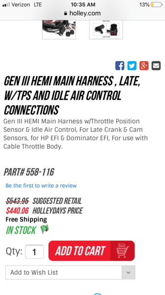

The Holley is like $495.00 does it come with all the knock, o2,and other sensor. If so it seems to be a good deal
.............>>???????????????.......... Uh, whut?? The Holley HP computer ALONE is more than twice that much.................
I must have looked wrong stuff when browsing.
that is the harness for gen3. you still need the hp ecu. its around 1400 for a complete plug n play holley hp setup harness ecu. you can use stock factory sensors as i am doing that. harness needs no mods just plugs in to existing sensors. load a stock gen3 hemi tune file and adjust to your needs or autotune to your needs.
