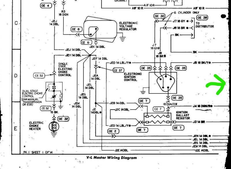

6. Cylinder duster is now a 340 ignition issues wants to start when you let up on the key
Sure. That's in the wiring diagram linked here
Download the pdf.
Brown is the feed.
The negative going to the ECU was probably black with yellow stripe.
The important thing is that the negative connects to the correct position on the plug.
Here's a '75 that doesn't look modified with slant six a/c and maybe cruise control.
VR is on the fender like yours.
The sticker on the fender is probably the vacuum diagram.
and another
This simplified drawing posted earlier is based on the factory diagrams.
The '73 - '76 diagrams are often broken up over several pages. When trying to follow a circuit, its worth colorizing or even redrawing just the circuits of interest.
In the Mymopar link for 1974 master Technicians Conference, there is a booklet and filmstrip about reading the diagrams.
Basically when it says J3-14BR, 14 is the SAE wire gage and BR is the color.
J5 18 BK/Y* is Ignition wire 5, 18 gage Black with yellow stripe
CE 37 = Connector Engine compartment 37 and has a seperate drawing in the service manual.

yes @67Dart273 posted it in the same thread.
This post.
Use that with the diagram.
J3 is ignition start and also the connection to coil
J2 is ignition run
G something are the gages
C I don't remember but you'll find it or figure it out.
S relates to the starter relay

Are you not seeing the links to the drawings?
One goes to a post wit a pdf, the other has snips posted including CE37
Not many ring terminals or open ring terminals used. So that one shouldn't be too hard to figure out.
CE1 (coil connections) are usually ring terminals.
Decoding is in the Service Manual. But @Bugman posted a photo of that page in this post
and in the same web page as the Seatbelt interlock booklet is one called Wiring Diagram Orientation.
along with a movie.
MTSC – 1974, Volume 74-11 Wiring Diagram Orientation – MyMopar
In addition to decoding, it also explains how to follow the wires on the diagram to find where they connect to.
