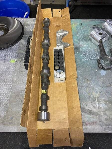

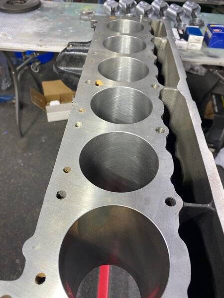

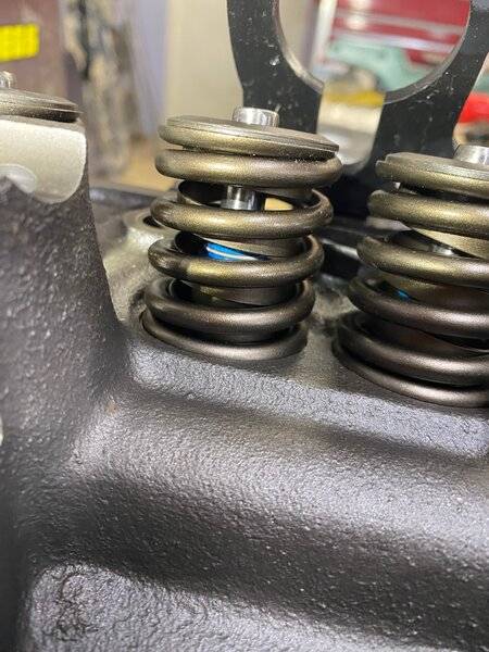

Just got back with my engine~ I was hoping they were going to install the pistons, but I can do it. Flywheel turned with the starter ring. camshaft from Oregon cams/lifters, new valve springs to match the cam, .40 over new pistons, :)9:1 compression(thereabouts), bronze valve guides/valve job. Hot tanked/ magnaflux. He says I may need new pushrods, but to let him know if I do.
I have to make dinner now;)
I need a gasket set, any idea of a good brand? and oil pump.

Darn, I don't have my gasket set yet, just ordered this morning~;), can't install the crank until I have the rear main seal/s. Well, heck, I guess I could install it, just slide it in once here! I'd rather install it without the crank in though. meh For fun, I installed the cam, lots of engine pre-lube on it. If I push it all the way in, it's kind of hard to turn, but come back a tad, it's fine. What keeps it from walking back n forth? and I'm amazed there is no cam plate. hm, I've been just cleaning the shop, looking at my new pistons, they're so shiny and pretty;) I was given the prescribed engine break in oil and Zinc additive.
