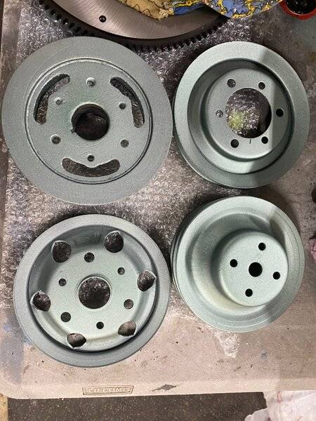

Got a little bit painted, primed, painted. The color comes out lighter in the pics vs reality, guess it's the metallic. I may paint the engine bay matt black, meh, but there will be contrasting colors, like an aluminum valve cover in matt black, or not. The super six decal is just laying on the lid. The sage green metallic is a very pretty color and sprayed nicely over the ppg shopline primer. Should be an interesting engine bay;)

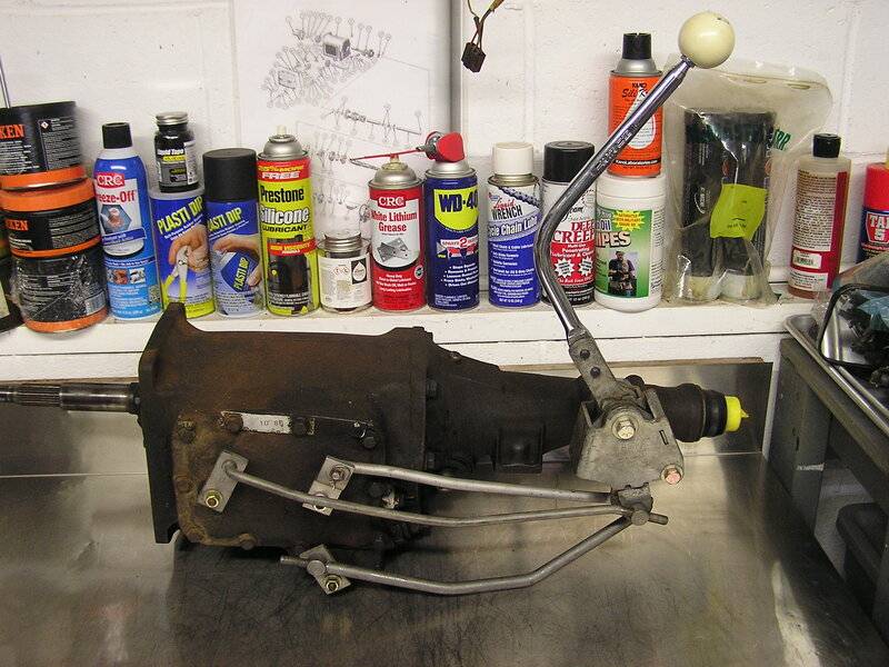

I don't think I've been so frustrated in a long time; If I were to do this over again, I know I could assemble in half the time. In the pics is the way I was able to "juggle" the back casing with my small crane, or as I call it, my little mule, actually is just a Hoyer lift as used in patient care. It balanced almost perfectly and for me that was the trick, Brains over Brawn. It's always a worry about the needle bearings, but it's just a matter of faith I suppose. Now waiting for 66fs to come through with the shifter/linkage~ .

This shifter assembly is coming to me from 66fs soon;) :thumbsup:

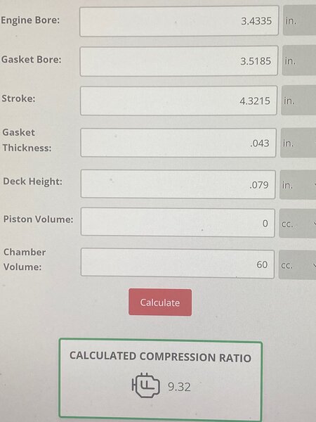

Today played with installing pistons, I come up with 9.32:1, depends on which calculator I use. I'll put the head on tomorrow and see if I need shorter pushrods. ok, got to go;)
the cc's of the head combustion chamber originally was 63cc and now 60cc

I pretty sure you are actually lower on compression than that, you have to account for how low the piston is below the deck.
