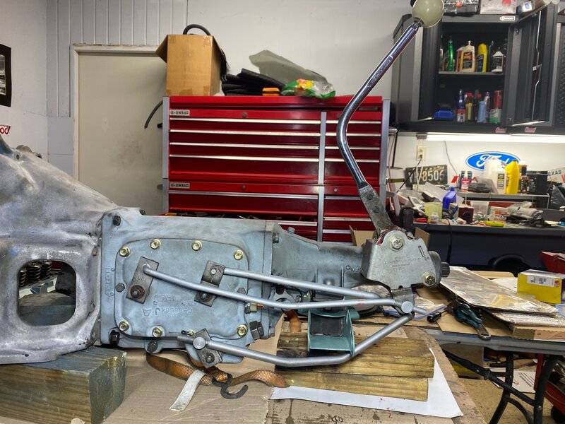

Wow, I worked today, getting the transmission in was a bit of a chore. I did it mainly to spy the transmission linkage, the shifter hump to identify location before welding in place.
Reverse, 1/2 clear, but 3/4th do not clear the floor board. Can the rods be bent to make clearance?
The middle of the 3/4 rod hit the floor board

I was thinking that, but the "leave" part is not very thick even if I remove it, I was just worried it may weaken the torsion bar crossmember down below.

I see what you mean, Looks like it could survive a slight bend to give most of the clearance you need, I would still check 3rd gear.
I think the 3/4 should be mostly straight.
It definitely needs more room. I think I'll just bend the one rod, but do I use heat, like cherry red, or cold bend? If cold bend, how do I do that other than run over with my tractor;)
heat for sure :) and it doesn't look like it will need much bend..
