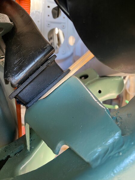

I have another question/concern.
I don't have a picture, but the front of the oil pan is pretty much touching the K member. The motor supports are new, but maybe not the correct ones? I found the link below, would those remedy the issue? :thankyou:
The right mounts make a difference. What do you have now?
I'm embarressed to say I don't know where I bought them! But they look like they were "sagging" already.

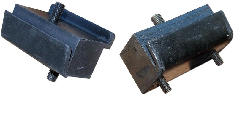

WEll, I consider that a good thing that they are not correct, what is correct?
How about these?
when figuring out a correct part # i usually hit rockauto's page to look up the part for what i'm working on.. helps take the guessing out
I ordered some, good advice on the Rock auto. they have great prices, but their shipping costs really bite.

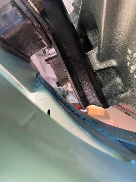

If the last picture of the trans from the rear is how it sits now with the shim under the driver side engine mount, it needs more shim . Also that bracelet seems to be bent at the mount .
Also the rubber idolaters seem to be under stress . Have been replaced ?
Hey Glen;) I've ordered new engine mounts and a transmission mount. I guess I had ordered the wrong motor mounts a while back, hopefully the new ones may raise it a bit, I hope.

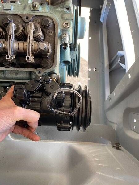

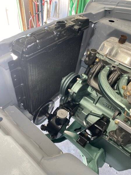

And also just arrived is my Mini me AC compressor, same one I have in my Triumph TR/mx, only this one it black, just have to make it fit, which I will;) I may or may not use the existing alternator bracket. Now for a small alternator for the other side of the engine~ this is fun!:lol:
