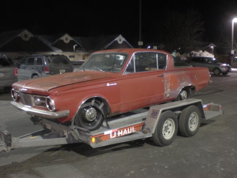

That color looks familiar! Here is mine when I first got it. Have made some changes this winter, will try to get some fresh pics in the next few weeks.

Yours looks decent. What have you done to yours?

Do you have some time? Since that picture, I have replaced the rear leaf springs, new shocks on all four corners, added disc brakes to the front from a '73-'76, rebuilt the entire front end, new torsion bars, new tires on freshly powder-coated Ralley rims, swapped in an 8 1/4 with 3:55 gears & a Trak Lok limited slip, dual reservoir master cylinder, full set of new brake lines, all new brakes, new steering wheel, replaced every hose & belt, converted to electronic ignition, put on a stock 340 4 barrel manifold, new fuel pump (twice), new 600 Edelbrock, new radiator, water pump, modified the power steering pump to "firm" it up, powder coated the grill, added the lower control arm stiffening plates and I am sure a few more things like a full tune up & tranny filter change. You asked! lol
I am also adding front & rear sway bars & a B&M shift kit next week. I plan on building a mildly strong 360 for it next winter, then painting it silver sometime down the road.
