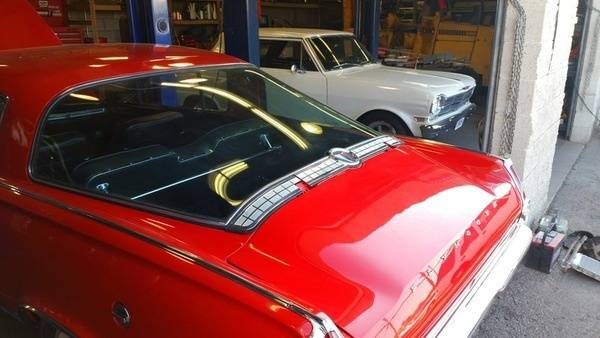

What color is your car going to be? I do like the grey center, I think they would look nice on a Burgundy colored car.
It's the original red. Almost all back together now. Holley f.i. on the way and some other goodies then it'll be good to go.
Wow looking good novaCuda. I think the grey centered wheels will look awesome on her.
The trim and chrome look like brand new. :cheers:
