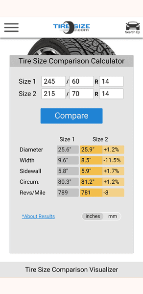

Hi All,
I am wondering about tires sizes for My B-Cuda. I have 14" Rally wheels I would like to put on it. It has the small bolt pattern. I did buy a set of used rims with tires
for it last spring. The tires on the rims are 245 60R X 14. When the car was on floor stands I put the tires on the rear and they looked GREAT. However, Yesterday I went to A & A and picked up the new tires, same size B F Goodrich tires. But, in comparison the new tires looked massive compared to the old ones which are Cooper tires. Any advice from anyone is GREATLY APPRECIATED! It's a plane Jane. So, no racing. Thanks for looking, Exponder
The other question is will the fit on the front? I didn't try to put them on the front so, Maybe they will rub.
I think it's going to be tight to not functional on the front.
215/70R14 fits on the front and rear of Darts with stock 5.5" wide steel wheels without issue.
But I think on Barracudas you have to change the length of the rod that supports the lower front lip of the fender.
Also my cooper cobras (215) are super close to the upper control arm, not sure if I have an extra 1/2 inch there.

If you're sticking with those 14'' rims the 245s' will be fine on the rear. I have those on my 14x7 with a 3.75 backspace slots (avatar) but have 235s' on the front because the 245 with the slots came a little too close to the front fender edge. Your results on the front may be different with those rims. I actually purchased two of the 245s' and tried them on the front first and then purchased the 235s'.
I had 205/70-14 on the front with no issues at all. I now have 215/65-15 on 6" rims the front and 245/60-15 on 8" rims on the rear. Don't know the back space but don't have any problem with them. Bobby
215/70-14 is the largest size that will fit all around on the 14" rally wheels. The rally wheels are only 5.5" wide, and 225/70 will hit the fender when turning. Barracudas are much tighter in the wheel well than Darts, with more tuck-under in the body side profile.
