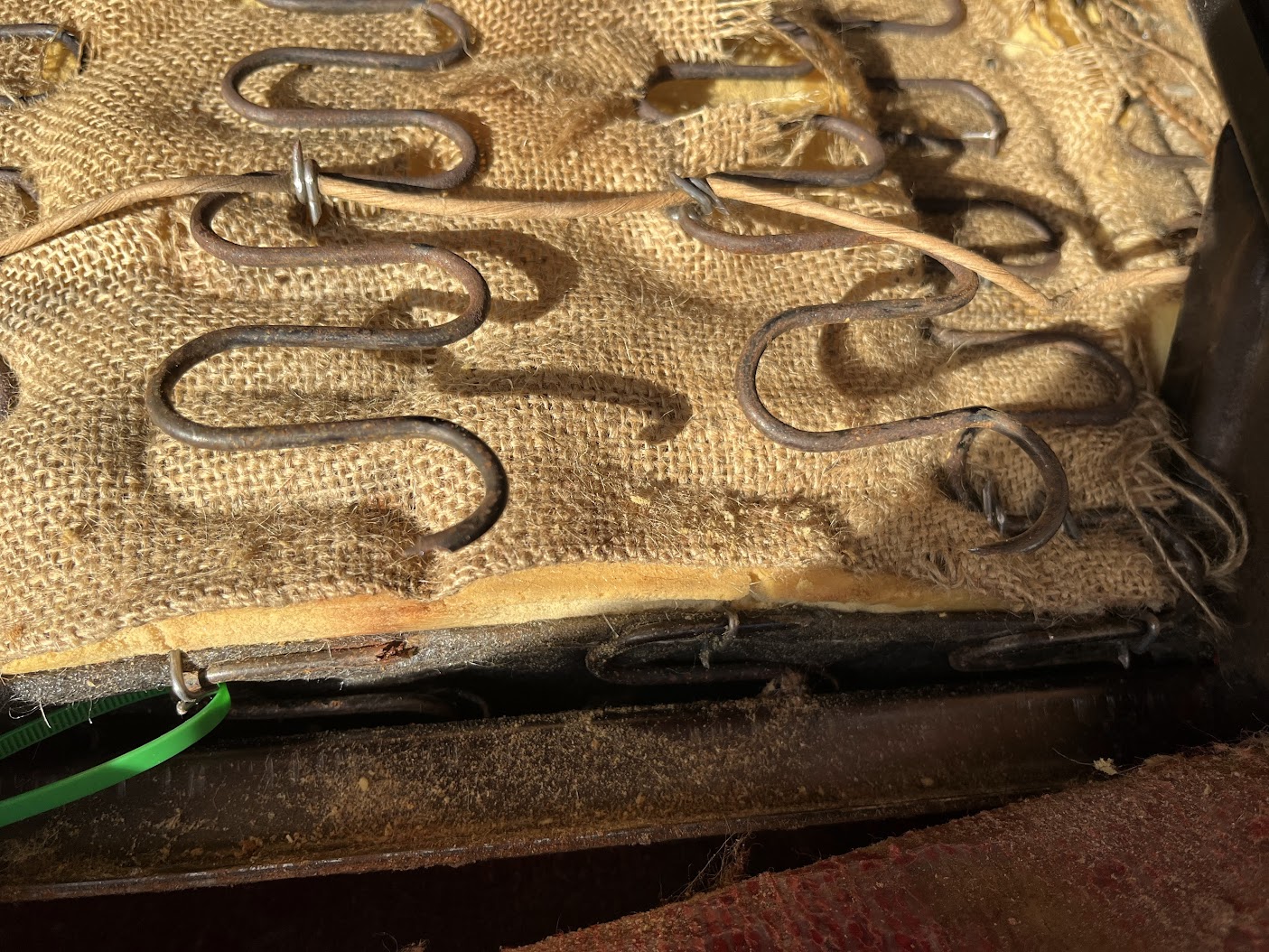

Speaking of seats... When I took stuff apart for the vent tube I had to take out the back seat bottom because I dropped some screws and they fell in the crack. While it was out I figured I could fix it. Most of it is in good shape, but the seams came apart in a couple of places. So I took the cover off and started going through the original holes with some upholstery grade thread.
AP1GczMj8P9PlKPkVUjo2434LsRf2Qaa_KZLA4-A-lqup0X6q1P7hLwYhblvCLBfEuynY6a80rEM4V30HW9WRdDaBO--LTd3Z7JgFDqezUstJb6_NEwQR1jQ7X4q__rbkGZevkQ3F_WumOBbv1TqVsv7yi9rXA=w1405-h1054-s-no-gm
Especially the passenger side bottom corner had a couple of rips, so I sowed a patch on.

You might be able to poke around on Google and find replacement seat springs. I know that I have seen them at some of the restoration supply vendors that come to shows like Good Guys, The Turkey Run, etc. They look like the ones in your pic, but come in cut to length versions. I was glad to be able to work it out so you could have the vent tube. I got the fill tube from Al as an extra to do a science project for my own 65 Barracuda. :)
Thank you again! I feel much better driving the car with the vent tube in place. That's a good idea for the seat spring, I might also try to find a rod I can bend with my tubing bender?!
