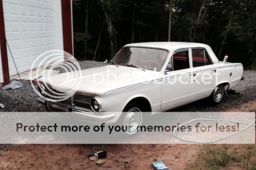

My Valiant arrived today... I was like a little kid on Christmas! The story is she's been in a barn for a few decades, then pulled out and brought to running condition.
I've restored a lot of boats. And I'm in the middle of restoring a 1966 Ford F100. But, this is my first vintage car, and my first MOPAR. So, I'm going to have a LOT of questions.
I almost hesitate to post this as a restoration, because it's really not- It's a refresh. Overall, it's in pretty good shape, So this is more of a refresh. It has been repainted, and it's an OK paint job, good enough for a driver-

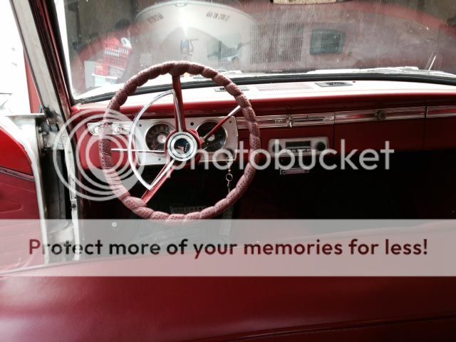

The interior is in good shape- There is one seam that tore in the back seat, and some fading in the plastic, but overall pretty good. Everything works as it should-

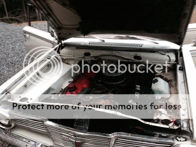

The engine bay is a little dirty, but not too bad-
A little degreasing and cleaning went a long way-

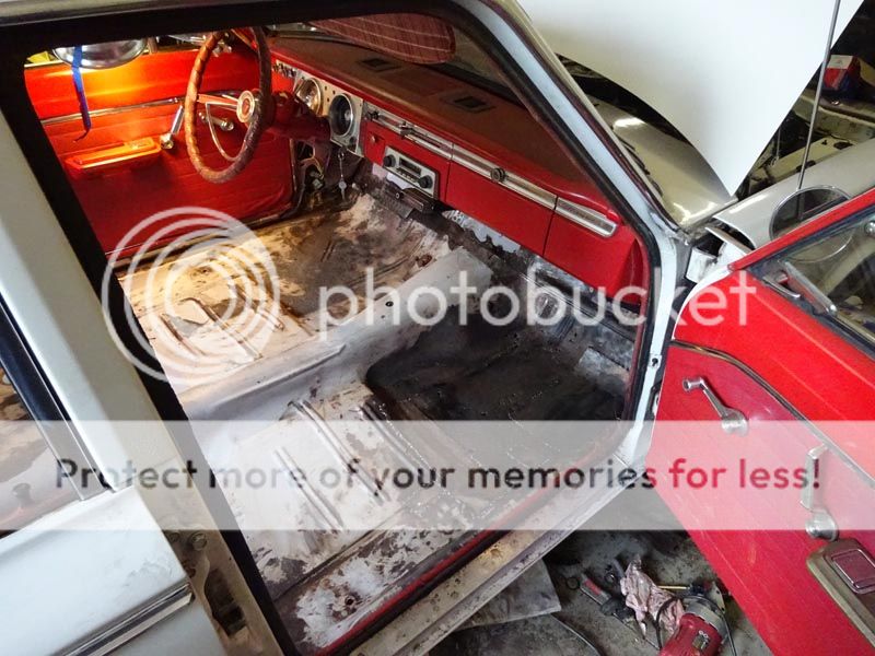

I've been doing a LOT of cleanup... I am installing new seatbelts, and pulled the rear seat out for access. Since it was out, I figured I'd go ahead and pull the front seat out, too, so I could pull the carpet out and get it good and clean, and take care of any rust in the floor.

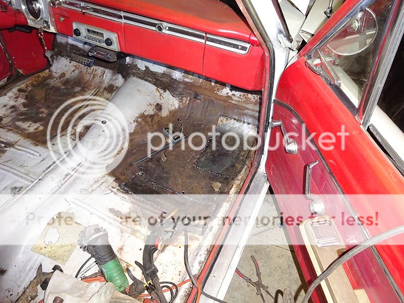

I got a kind of nasty surprise- The floors appeared to be VERY solid from the outside, but the front passenger side wasn't so great. It had been rusting from the inside out... I removed all the rust and scale with a wire wheel- There are a few holes to fill. I'll have to do a little welding after all!-
A little more than I thought I'd encounter, but not bad. It'll be an easy fix. I'm tempted to use the POR-15 floor repair kit for this job.

I hadn't PLANNED on doing any welding on this project- But plans change!
I cut out the bad steel, and tacked in some new-
It appears that water pooled on the floor- And they rotted from the inside out! The bottom of the car looked as good as new, but the inside was a different story. I'll be finishing it up the floor with POR-15, To seal it off and hopefully prevent it from happening again!

I wire wheeled the rust and scale out-
Then I got a coat or POR-15 on-
In the areas where the rust was really bad, the floors were a little thin, so I reinforced them a bit with some 3/4 oz. fiberglass mat. Essentially the same thing the you do with the POR-15 floor repair kit (http://www.por15.com/Floor-Pan-Repair_ep_77.html)- But you REALLY don't need everything that's in the kit, it's a lot cheaper to buy just what is required!
It'll get a second coat. Should seal off the floors nicely and keep anything like that from happening again.
