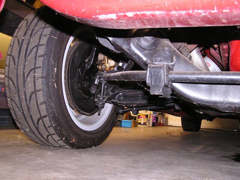

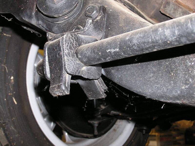

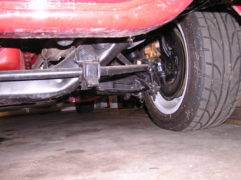

Yep, just like mine I bought from a great member and friend here 12 years ago, 66 barracuda sway bar is now on my 66 sedan.

Yours look a bit beat up, but, they're not a precision parts, so, being a bit crude is not unusual. Side view should look a bit like an A shape and symmetrical, with the legs of the A flared out a bit below the cross piece.
