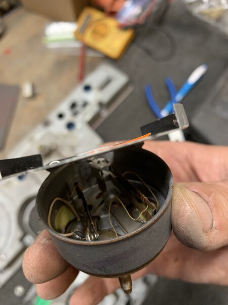

My electrical problem is that I believe that the 5 volt voltage limiter in the fuel gauge is burnt out. Temp and fuel gauges are not reading.
Oil Pressure is reading but my wiring diagram shows that the oil pressure guge feeds from sender so I assume that the voltage limiter controls just temp and fuel. Am I correct please?
When we a had the gauge pod unscewed from the dash, but still wired up, we grounded the third post of the fuel gauge through a circuit tester and the tester lit up in slow blinks, does that sound correct ?

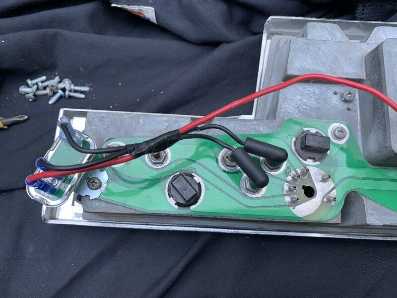

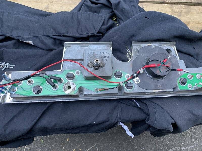

Yes I have on my 66 Barracuda cluster.
I ended up wiring in a separate IVR to run my cluster and it works great. You do have to disable the one inside your fuel gauge. I’m sorry I don’t have photos this second but use the search feature for IVR and there are posts about it including mine to help you.
PM direct and I can send over what I have at a later date. Trying to get off to work now.
Syleng1
Okay I found them quickly:
The new IVR was for like a replacement 72-76 dash cluster for my 72 demon but electronic not factory mechanical.
Black wires were for the fuel gauge studs and the red wire was key “on.”

Mattax- if you put a volt meter on the gauges while in the car and wired up the factory unit pulsed. It came “on” then the little bi- metal strip heated up or “tripped” and the system goes dead and it recovers rather fast then does it again.
That’s how it got the roughly 5vdc.
Mine did not do that any longer. I had a good gauge but it was in rough shape to verify it. I went to the electronic and my gauges are very happy now. Quick to respond and smoother than original.
Syleng1
Thank you so much, That is exactly the answer that I was wanting.
Very much appreciated.
Thank you for posting those poics, and your explanation and the tip to look on Ebay, You have been a great help.

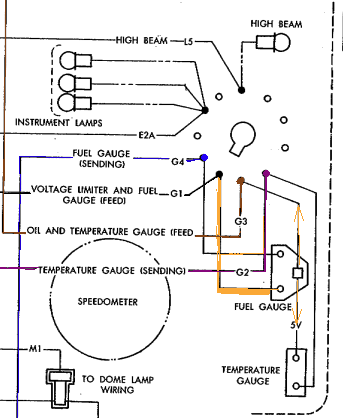

The IVR in the fuel gauge runs all three gauges....oil, temp, and fuel. The power for the oil gauge runs through the dash harness to the other circuit board. If your oil gauge is working, the IVR is working also (although I would change to the solid state one anyway to keep from frying the gauges should the factory IVR stick on full power). Chances are, you have a bad connection, loose pin or nut, or broken trace on the circuit board. a simple test light should be able to track that power loss problem. Start at the IVR output on the fuel gauge and work your way to the post on the other gauges.

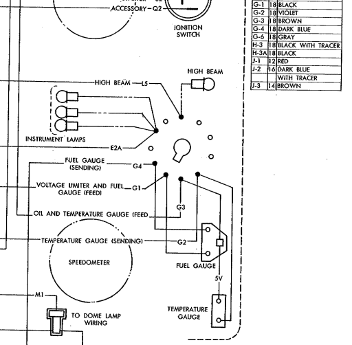

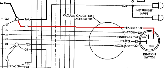

The same Master Tech Conference has sessions on how to read the wiring diagrams.
Lets look at the '66 Plymouth FSM.
The dashed lines represent the instrument panel.
Wires are identified by a code. G is for Gage. Number is the circuit and a letter, if present, is a branch.
In the key is the wire color and SAE wire gage. So G1 is 18 gage black, and my guess is that is the power supply from the key switch. Lets look.
Yes it its.

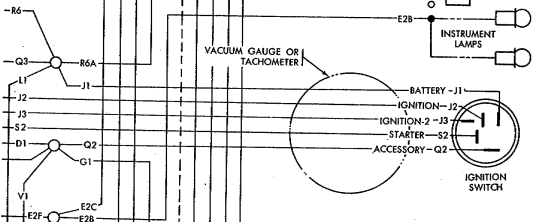

How do we read this? The circles represent junctions. Usually they are solid circles but for whatever reason in this case the welded junctions are larger open circles. Wire G1 joins wire Q2 coming from the ignition switch.
J1 is the feed into the key switch. Its always hot and by accepted convention the connections are marked Batt or B or Battery. Don't let this fool you into thinking it comes direct from the battery. It comes from a junction joining the battery (wire R6A) and the alternator output power (wire R6) to the main feeds. Lets color these in.
When the key is in Run, there is power at the switched accessory terminal as well as the ignition run terminal.
Lets color those in. (even better sometimes is to redraw the circuits we're interested in on apiece of paper)
Now lets go back to the instrument panel connector.
G1 brings power in. We call it 12 Volts (even though its really close to 14.5 V when the engine is running)
The solid dots represent the connected terminals.
12 Volts is available at the Fuel gage. Inside the gage it connects to the IVR.
From the IVR reduced (pulsating) power is available to the fuel gage resistance wire.
Via the circuit board it the the IVR power is available to the termperature gage.
It seems the IVR feed to the oil gage on the other board is incorrectly marked "Oil and Temperature Gage". I would guess that confused things.
The only thing wire G3 feeds is the oil pressure gage.

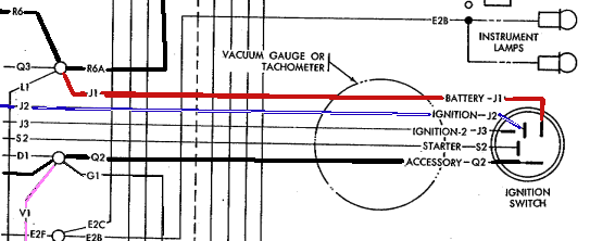

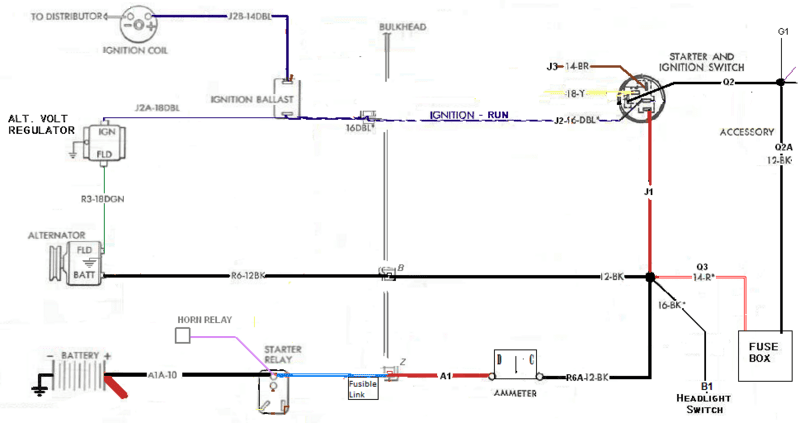

Here's how the 66 Barracuda main circuits look when the diagram is redrawn in to a schematic just focused on them.
Thank you for all of your help, I am learning so much from your posts ! :thumbsup:
