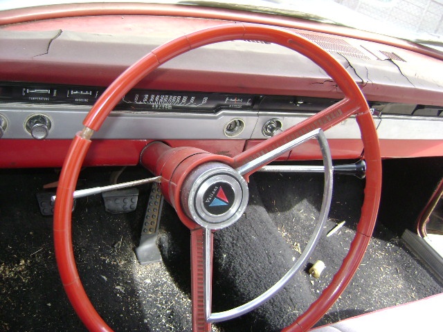

Yup, same setup on a '66 Dart if it has a factory wheel. I don't remember any horn rings that just pry off. A photo would help I.D. the type of wheel you have.
you have to pry off the center cap before accessing the 3 screws, this cap is a press fit with a gasket around it, there will also be a sponge type spacer underneath the cap once removed--
if the poster has the cap off the screws should be visible & self explanatory.
getting that thing off (the cap) will require finesse without breaking anything.
pictures would help, all bets are off if it is not the factory wheel for a 66.
his wheel should look like this:
http://www.forabodiesonly.com/mopar/attachment.php?attachmentid=232375&stc=1&d=1304469494

It is indeed the original wheel like the one VDART posted. I knew there had to be something I was missing.
