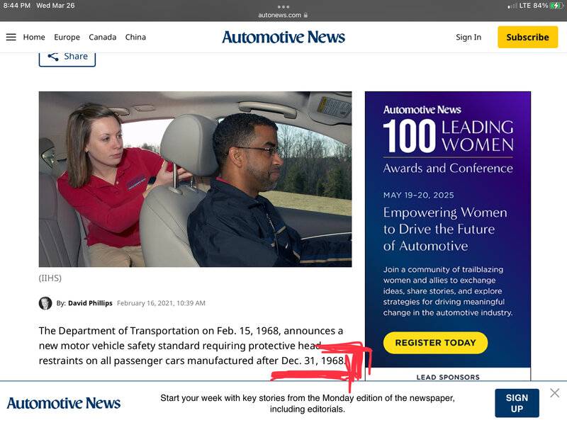

The law was Jan 1, 1969.
From 1967 model year to December 31, 1968 they were optional as far as the govt was concerned.
Head rests became available in 67. It makes sense that the frame would be redesigned to support that option — they wouldn't want to be messing around with two different frames on the production line.. We should probably be more precise, and state that "66 and 67 seat frames are identical EXCEPT for the provision for optional headrests in 67". But most people are really just asking, "Are the foams and covers interchangeable?"
To my understanding, headrests were mandatory by law January 1st 1968. You just got believe auto manufacturers knew it was coming much earlier than that, like in 1966 already.
