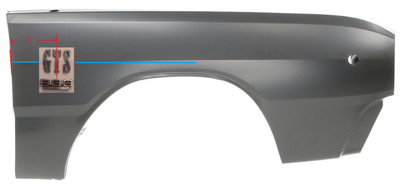

I know it has been asked (and I have asked) and I have searched and found several examples of dimensions, here on FABO and one the net.
BUT...
  1. None have certain crucial dimension
  2. Many are not from a KNOWN OEM front fender
The reason I'm being so picky for KNOWN OEM fender is there are so many restored cars out there with the fenders replaced that the placement is a bit all over the place.
(Please be sure you truly know the fender is OEM, like it was a parents car, or you bought it new, or it was your life long neighbors car that you know the history of.)
Thanks in advance
This is where I'm at right now. I'm very happy with the look and my template works great.
Some dimensions I need are:
If from a 68 GTS but not a 383 that's ok I'll take what you can provide
Fender lip to center of the T at the style line
(This can be done with a tape measure, at the style line is important as the edge of the fender is not vertical and the style line gives a consistent point of reference)
The dimension between the G and the T
Preferably with a caliper
The dimension from the center of the bottom of the T to the top of the 8

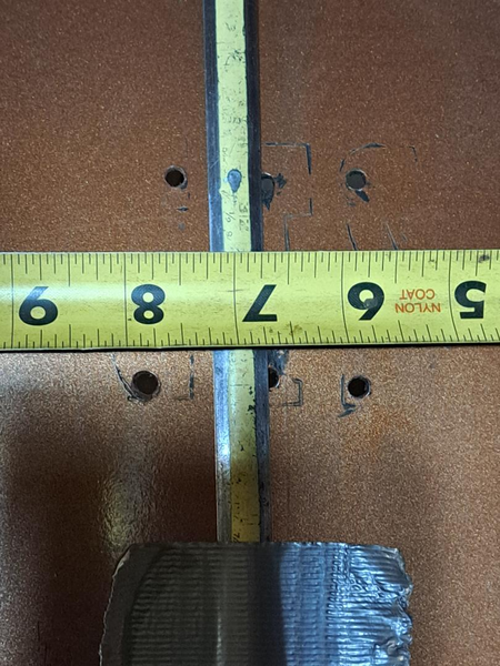

Okay, here we go.
Got out to the shop for a little bit this afternoon and got these measurements for you-
First up is an original '68 340 GTS left fender.
I ran a straight edge vertically through the centers of the "T" mounting holes, and then held the tape measure (top edge in pic) along the body crease. Comes in right at 6 3/4".
Next, since the outlines of the letters are still pretty visible, and you expressed an interest in the spacing between the letters, I took this shot with the tape along the bottom of where the letters were:

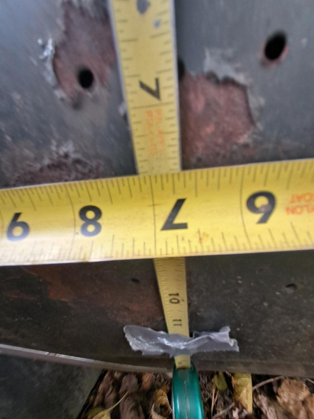

Next up, is a '68 GTS 383 left fender in all it's rusty, horribly crusty, but original glory.
Same method of measuring as in the first picture, this time coming out to a little less - a bit closer to 6 5/8".
Forgive the crummy pictures and awkward camera angle, this one was a pain to get at. Had to limber up my contortioning skills.
But since it was a 383, I thought I'd try to get a shot of the "383 4 barrel" mounting holes while I was at it.
So there's this one, showing the distance to the hole closest to the fender trailing edge-
And this one showing it's distance below the body crease:
Looks like about 2 1/4".
Again, sorry for the crappy angles.
Hope these help.

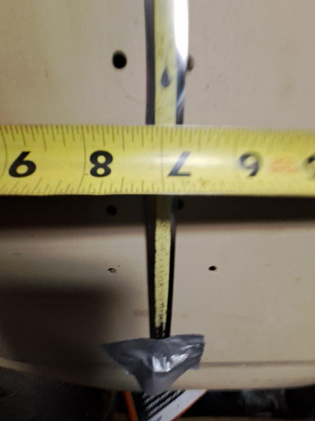

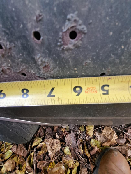

Now, just for sh*ts and giggles, here's a couple of shots of the mounting holes from a '68 GT left fender:
Again, same as before, measuring through the centerline of the "T" holes at the body crease.
Looks to be right near the 6 3/4 mark again. Interesting. The "G" and "T" positioning is the same on both models, GT and GTS (at least on the left sides).
So, between these two examples and the Previous GTS that I posted, it looks like the go-to measurement to the "T" centerline is going to be "loosely" at 6 3/4". A template was most likely used, but it's placement probably allowed a slight bit of variance.
Thank you for those measurements. They are right in line with each other and others I have seen / measured
The spacing between the 383 and the style line is off by 0.250 from what I expected.
I have it at 2.474 ( call it 2.5") and you're showing 2.25". 2.474 puts the top of the 8, 3/4" from the bottom of the T. You're measurement puts it at 1/2"
How confident are you that your fenders are OEM?
my 3/4' came from several Googled photos and who knows about them!
If they centered everything on the T then the basic spacing would make sense that the S was just added after.
The yellow GTS in my original post, I have owned off and on since about 1980, and was familiar with it prior to that.
The copper-colored fender in the first pictures of this post was from a GTS I bought in 1976, sold when life got in the way, and bought back the hulk after the next owner wrapped it around a telephone pole.
The dark green 383 I bought back in about '78 or 9, sold at the same time as the copper one, and bought back about 5 years ago after it got hit in front, had a garage collapse on top of it, and then sat under a pine grove for about 25 years... still not sure what I'm going to do with that one, not much left of it.
Regardless, I can account for all the sheetmetal shown for over 90% of the cars' lifespans.
Also, remember these are all '68s- I see you did a compilation of '67 fender possibilities. If you are looking at doing a '67, I can't guarantee the emblem placements are the same, even though the emblems themselves are the same. I have no '67s to compare to.
Since there are so few 67s I'll go with the 68 numbers as they probably came from the 67 anyway.
I would say your GTSs are the real deal. Not likely 3 - 10 year old cars would have had both fenders replaced and then during your tenure you know 90 percent of their history, and again unlikely both fenders would have been replaced on 3 cars.
I'm convinced your fenders and measurements are spot on.

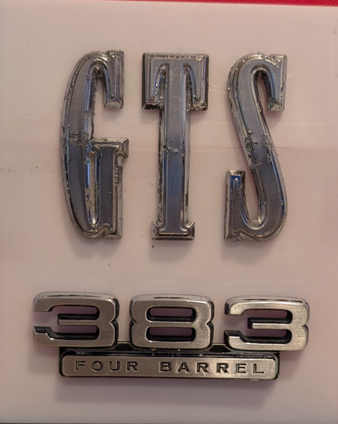

I was today years old when I discovered the 67 Dart GT had a completely different emblem/engine callout than the 67 GTS, or 68 GT.
Also, check out the placement of the 68 GTS emblems in the press release.
Same as production but must have had a 'bend' lower.

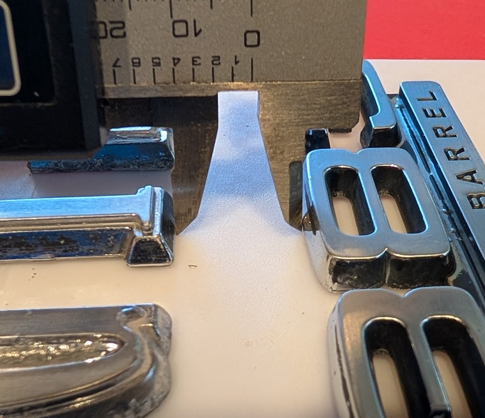

Bottom of T to top of 8 spacing
3/4" spacing on the left (or first)
1/2" spacing on the right (or second) This aligns with the 2.25 spacing from style line to left most post that is behind the 3, that the Professor measured.
I'm still looking for additional known OEM measurements especially between the T and 8 --- 67 preferred but 68 accepted
