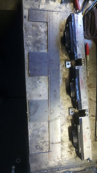

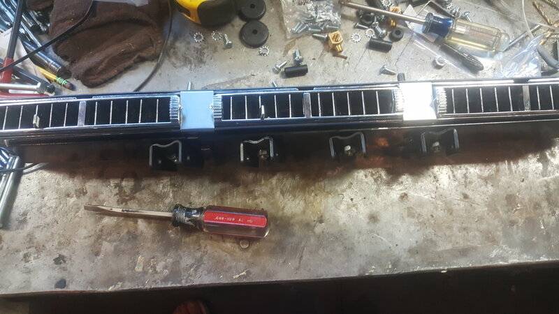

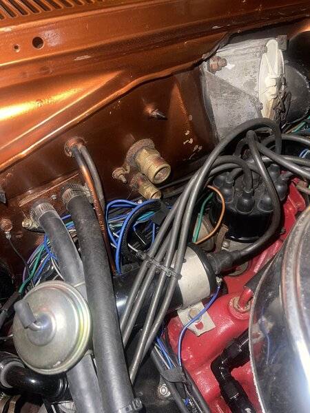

I am at a crossroad with the factory air in my 67 Barracuda. All that is left of the factory air under the hood are the two ports in the firewall. Inside the car, the push button controls remain along with the vents and coil system under the dash. A/C would be nice especially living in Texas although I am afraid we may be chasing something very difficult to maintain.

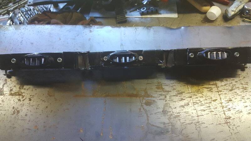

The interior of the car has been restored to look as new a reasonably possible with the exception of the under dash vents that will cost around $1000 to restore by the time I pay shipping both ways and have it re-chromed.
So here are some questions I am hoping some members here can help with:
1. Do you still have factory air that works in 67-69 Barracudas?
2. Are there replacement parts for under the dash available if I need to rebuild?
3. Has the system proven to be fairly reliable once rebuilt?
4. Can the original coil inside the dash handle refrigerants available today?
5. Is the pushbutton control system fairly straightforward to work on?
6. Any idea of a ballpark cost to get the air working with nothing under the hood and typical repairs inside the car?
7. Are there companies that specialize in restoring these factory systems on a-bodies?
Sorry in advance for all the questions. I owned a 67 Barracuda many years ago as a teenager without air so am not familiar with the system. There is also a linkage arm hanging down in the last pic that I am not familiar with. Moving on without air is my other option if this proves to big of a beast to tame.
Our 67 is an AC car, and while we have all the underhood ac components, there is no chance I would invest any $$ in it.
The push button switch is amazingly expensive and not repopped. These are plastic and very brittle. They MAY be able to be repaired.
For what u were quoted for rechroming diffusers, I would invest that in an aftermarket ac kit. More reliable, effective and use the current refrigerant.
Sorry I didn't answer many questions, Just posted opinions. The ac diffuser is a very nice looking piece and we left ours intact as it looks awesome.
Good luck.

If all you're missing is the underhood components, consider an "Underhood Upgrade" kit offered by Original Air (a division of Classic Auto Air). Includes everything under the hood, designed to hook up to your factory in-cabin system and controls.
MOPAR STAGE 1 | Original Air Group
MOPAR - STAGE 2 & 3 | Original Air Group
I bought that kit for my '69. It does not include everything. Its missing the hard line on pass inner fender, the small hard line between expansion valve and evaporator core both of which must either be fabbed up OR found used. The bracket for filter drier is missing, no hard line between condenser and filter drier, and no condensor. Its is far far far away 'from including everything under the hood'. Its a 'compressor upgrade kit' not a 'I Am Missing Everything Kit'.
And if you have the 3 groove factory crank pulley the '69 and back kit does not use the AC belt groove. Instead, they supply a complete crap bracket setup that directs you to use one super long belt to go around crank, AC, and PS.
So the Original Air kit assumes you have a complete factory AC under hood setup already and if not you are left to go round up all the missing parts yourself. And you can call them up, get put on hold for an hour, just to be told they don't care, they don't know anything about anything, you get what you get, don't bother us any more.
I have all the details of my AC install in my T56 swap rusted floor thread. It does blow ice cold but thats after I jumped through all the hoops to make it fit and work correctly. And luckily I had all the under hood parts NOT included in the kit.
