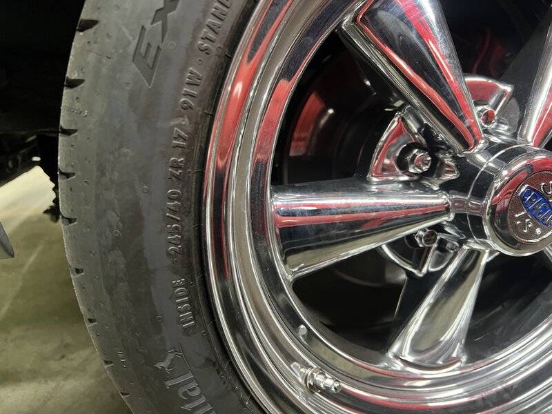

For reference, I am running the hellwig 5906 on my 68 formula S with 245’s up front with no clearance issues.

That's fortunate for you, but it is backspace dependent and at only 24.8" tall those are some pretty short tires. Running a tire that's more than 25" tall like most folks prefer would also reduce the clearance to the bar. Typically the 245 mark is where clearance issues with the stock 67-72 sway bars start.
The #55917 bar exists because a FABO member with a Barracuda wanted to run 245's up front and had clearance issues, so he worked directly with Hellwig to get the 55917 bar made, and that bar will allow for up to 5.75" of backspace on an 18" wheel. Which still probably isn't enough to get 275's or better up front like you can do with the 73+ style sway bars.
