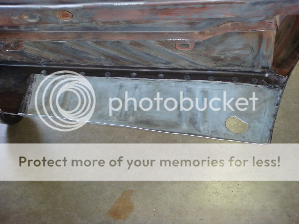

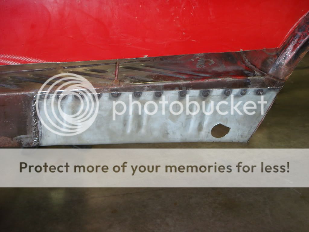

Here is a modified one. I just cut to fit and weld it up. I lapped the patch on the inner side and but welded it at the rear.
