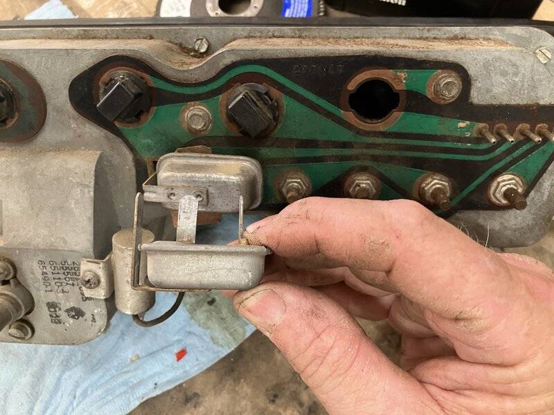

To date, I have tested both the wire to the temp sender and the fuel sender. In both cases, I took a jumper wire and clamped the terminal inside the wire plug and grounded the other end of the wire. I recall that this was one way to see if the gauge moves. In both cases, the gauges did not move.
Next I pulled the panel out enough to swap in another voltage limiter. No change.
I swapped in another panel, no change.
The dash wiring looks good. No damage. The terminal plugs to the pins are in great shape. The engine side wiring is seasoned but still looks okay. I pulled the bulkhead plugs and cleaned the terminals.
No change.

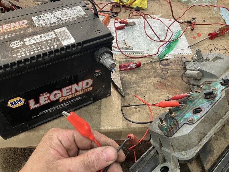

I took my original panel and a standard car battery:
For the gas gauge, I momentarily touched the battery terminals and…
Then the temp….
These work, maybe the ones in the car work too so what else is there?

No 67 plugs in. Also the finger contacts into which it plugs may not be making contact with the traces on the board. Clean them, flux and solder jumpers from the contact fingers to the board traces.

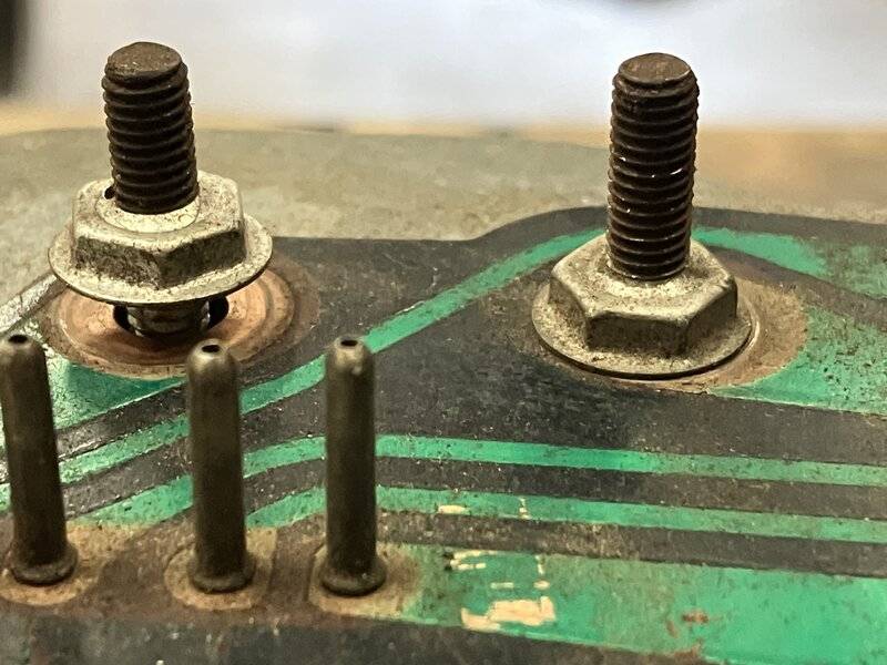

Take the gauge nuts and loosen/ tighten them 3/4 times to "scrub" corrosion off.
There are several things you should do while troubleshooting this
Examine the harness connector pins, which are sort of riveted to the board. If they seem the slightest loose, clean them up, use a flux suitible for electronics, and solder them.
If you do not have a source for a suitable flux, this stuff is not bad. They also sell liquid flux in "flux pens" but it is more expensive. This stuff is "waxy," you just clean up the joint and with a small screwdriver, etc, spread a little bit on. Also be sure to use electronic rated solder, and I would use lead / tin solder, rather than silver. Make SURE that the solder ALSO has electronics compatible (rosin) flux AND NOT ACID CORE
Find a common ground point on the board and install a pigtail so you can "for certain" ground the board by bolting the pigtail to the column support/ dash frame.
If you have anything for a rheostat, such as a spare gas sender, you can set it to certain resistances and test the gauges. They all have the same sender resistance for far left, middle, and far right on the gauges

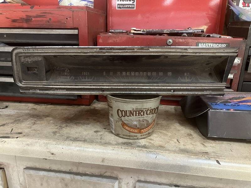

I backed off every speed nut and screw that went through both circuit boards.
This is the panel that was in the car
The oil light does not work because I used the oil pressure port for the gauge.

If you fed it power as it normally should have been, the ignition "run" line to the cluster, the gauges run off the IVR. If it's bad, it would not feed power to the gauges. Not sure, otherwise, unless, just bad connection. As I said the studs can lose contact with the board traces, as well
Del wrote this in another thread.....
Common problems:
Voltage limiter. Buy a RTE solid state one
Bad connections between limiter contact fingers (if this is not a Ralleye dash) and the PC board traces. Solder jumpers across
Bad connections at gauge stud nuts. Loosen/ tighten nuts several times to "scrub" the connections clean, and consider replacing nuts
Solder around base of harness pins after cleaning, inspect for damage.
The electrical "path" for the gauges is ignition switch----harness connector pin----to voltage limiter---branch off and PC board trace feeds power to each gauge. Through each gauge, then back on traces to harness connector pins, and out to senders. Fuel gauge goes down to left kick panel connector, out to fuel tank, temp goes through a terminal in the bulkhead connector and out to temp sender
You can use resistors or a variable / rheostat to generate proper test resistances to check gague accuracy.

Having two gauges dead points to a bad voltage limiter. Like I mentioned before, I wish I knew how to test the ones I have here. I'm not against buying a new one but if I already have one here, I'd like to use
Take an IVR and ground it's housing to the negative of the your 12v power source.
Then after determining which terminal is the 12v in, connect that to the positive of your 12v power source.
Hook a small 12v bulb to the output terminal of the IVR and the negative terminal on your power source, you should see the bulb flash on and off .

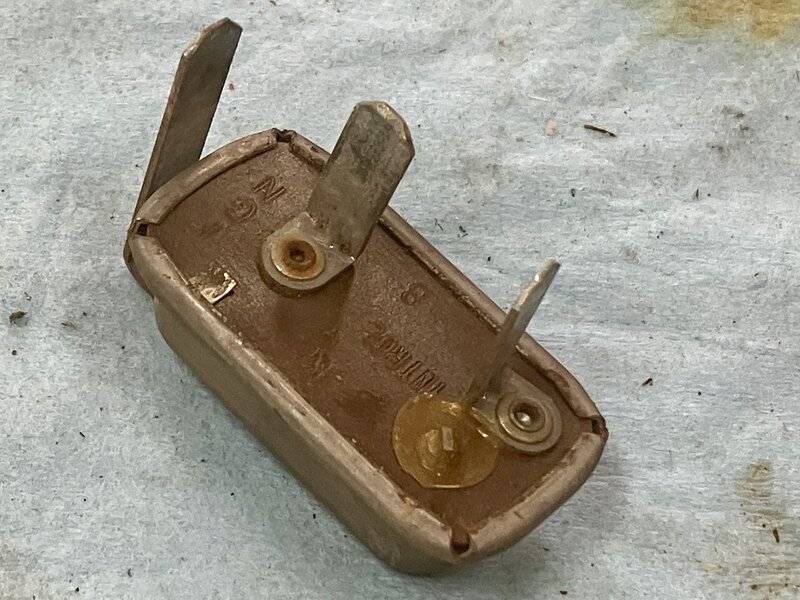

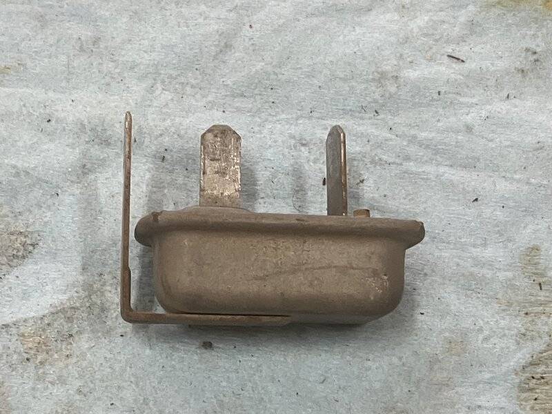

First, I tested a limiter on the table as directed and got fluctuating numbers on the multimeter, just like it is supposed to.
I put the limiter in the original cluster after cleaning all the contact points. I put the cluster in the car and saw the fuel gauge needle move slightly.

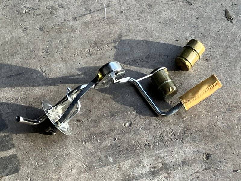

I pulled the sender and found this:
A tear in the float. It was half full of fuel. I grabbed a good used one from the stash and tested it in a bowl of water.
No bubbles.

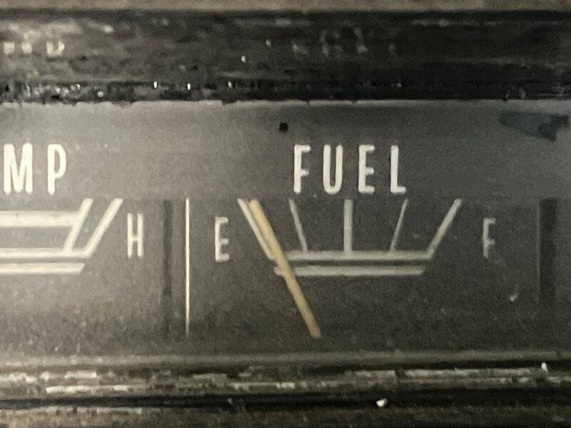

Back together, the fuel gauge moved right away. There is maybe three gallons in the tank.
This dude reads with so little fuel in the tank? That is better than my nicer car!

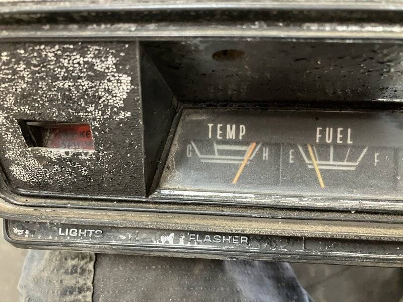

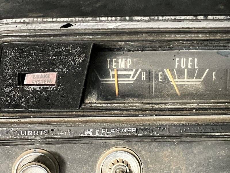

Ten minutes or less and this is what I’m getting:
Score!
In short, corrosion on the terminals was probably responsible for the gauges not working but the fuel sender float should have been checked earlier to rule it out.thanks again, guys.
