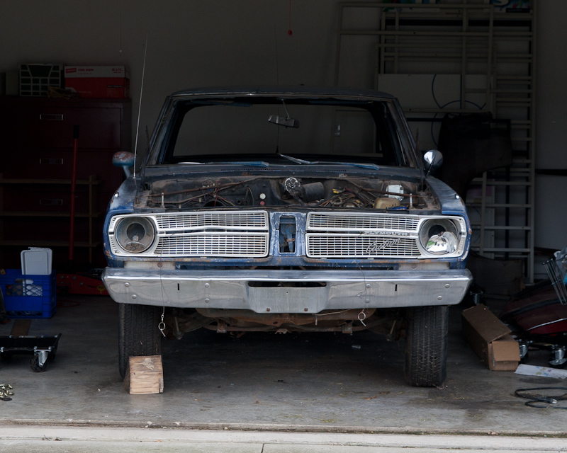

I worked on the car for a few hours today. It started out looking somewhat like this:

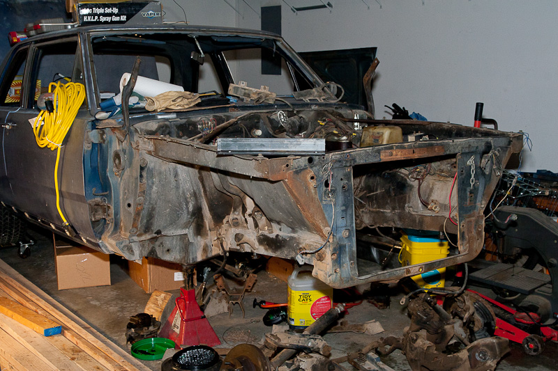

and ended up looking like this:

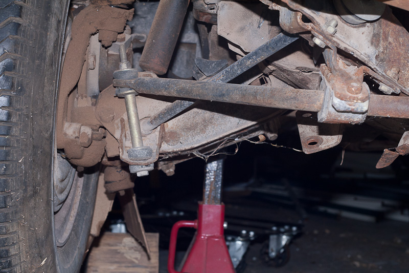

From this pic it looks like I have the earlier lower control arms and swaybar/k-member setup, but I've got the '73+ disc brakes, from some digging I've done earlier. I guess someone swapped UCAs and lower ball joints to accomplish this. Does this look right?
No confirmation on my swaybar/brake idea? :(
Splash shields and fenders came off tonight,thanks to the tip about the splash shields from 340Dart on the web chat. Only took something like two and a half hours...A pro I am most certainly not, but this is my first go at tearing a car down this far.

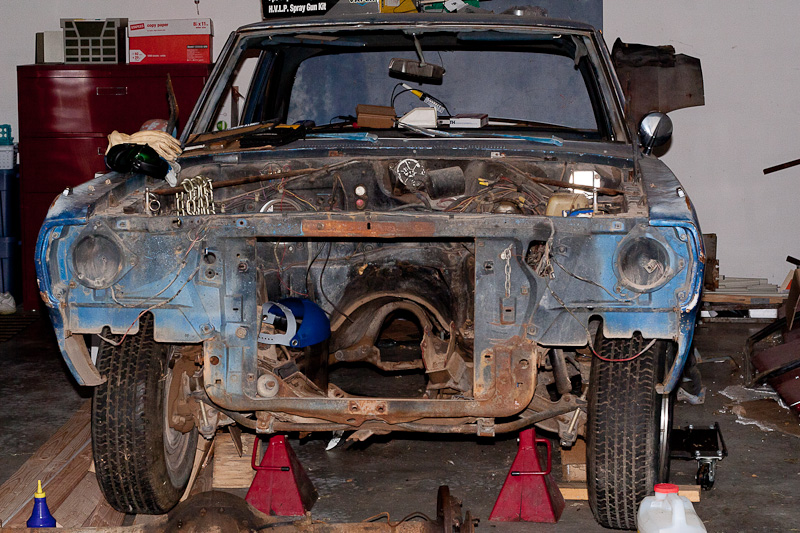

The rest of the front sheetmetal is off. Master cylinder is drained, lines disconnected from the master cylinder and the front brakes, front brake calipers and brackets are off. Rotors seem to be held on quite nicely, but I'll get them off. :) Now the only thing holding the k-member/suspension in the car is bolts.

From this pic it looks like I have the earlier lower control arms and swaybar/k-member setup, but I've got the '73+ disc brakes, from some digging I've done earlier. I guess someone swapped UCAs and lower ball joints to accomplish this. Does this look right?[/QUOTE]
Didn't see a pic of the rear, but don't give up on your rust-free deck lid. New metal can be welded in to save it. I remember seeing after market patch panels to fix that area for more popular cars. (read GM here) Your original K was cut for oil pan clearance so your car may have a drag racing history, or the start of one but never accomplished. The gap in the firewall was definitely cut, not torn. That too can easily be welded up and ground so it disappears.
Yeah, you have 73-76 front discs w/ matching UCA. LCA and sway bar are still 67-72. A 73-76 sway bar goes THROUGH the K and the bushings bolt to channels held on by screws and nuts. Also, the motor mounts will now be spool type, not 67-72 biscuit type.
Otherwise, keep at it.
