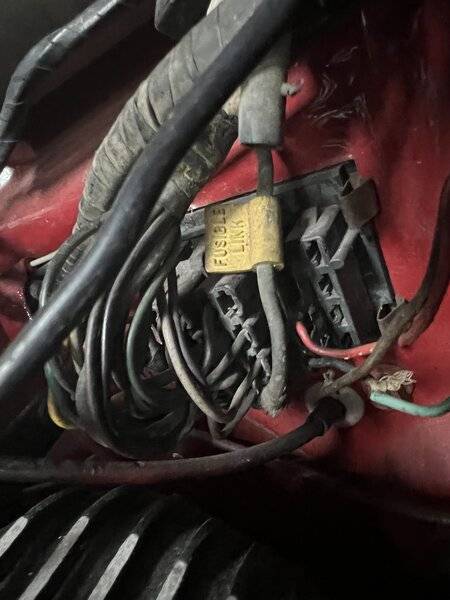

BTW something not mentioned here is the Bulkhead Connector carries all the load of the car through 2 connectors. one into the cabin and one out of the cabin. there are kits to reduce the load on those connectors to prevent fires.
