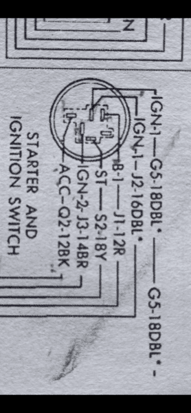

Ok, so here's my problem...On the ignition switch the "IGN2" tab where the Brown wire connects should get power when switched to the "on" position and stay on when the switch is moved to the "crank" position and stay on again when released from the "crank" position back to the "on" position, because this wire goes only to the coil +.
So, the old ignition switch wasn't giving this Brown wire (the IGN2) tab when moved to the "on" position, it was only giving power in the "crank" position. So, I took the old ignition switch out and pulled it apart to see the inner working of the switch.
Sure enough the Brown wire (IGN2) tab doesn't get power in the "on" position, only in the "crank" position.
So, I went to the auto parts store and bought a new ignition switch specifically for a 1968 Plymouth Barracuda 383. I'm having the same frigging problem!!!
Do you think both the old and new switches are bad? Were these ignition switches designed this way for some reason in 1968? I can't imagine the coil only getting power when cranking, and losing power once released to the "on" position.
At this point I'm thinking I have to return this new ignition switch and try and find one that gives power to this IGN2 tab when in the "on" and "crank" positions. But, I don't know if anyone makes one or where to get it.
Any help with this that anyone can provide is EXTREMELY appreciated.
Thank you in advance!!!
Attached is a picture of the Ignition switch wiring...
  • Ignition switch.pdf
You have two switched ignition wires. Ign 1 is blue, Ign 2 is brown. Ign 1 has power in run position and feeds power to the coil thru the ballast resistor. Ign 2 has power during cranking and feeds the coil a full 12 volts for starting, bypasses ballast resistor.
If your running an MSD you want to splice Ign 1&2 together to feed the MSD box switched ignition input lead. Doing so provides power during crank and run.

There has been some questions about connection changes 67-68 and 69. That 68 FSM diagram may be wrong. I don't have a 68 to compare with.
Here's a 67-68 (and probably 69) replacement switch with the posted diagram from above and as observed it does not match up to the labels on the start, Accessory and Ignition 2 (start) terminals. The wiring should match as drawn below.
Here is the factory '67 connector. It matches the SMP replacement switch marking

I am pretty sure you are incorrect on this statement. I just looked up the 68 and 69 manuals which I downloaded from MyMopar and they match, and they match what Mattox posted above. Were you maybe viewing the connector from the wrong end? These are laid out as if looking at the switch terminals

YOU MUST jumper IGN1 and IGN2 at the ignition switch together, either under the hood or at the ign switch. The junction of those two feeds the small red of your MSD
This is because IGN1 is ONLY hot out of the switch in the "run" position, and provides power to the cluster, VR, and ignition system. IGN1 GOES DEAD when you twist the key to start. The ONLY power to ignition system during cranking is the IGN2 terminal from the ign switch, which feeds the coil + (originally) during cranking
^^This^^
The MSD's on/off wire can be connected to either Ign 1 run (wire J2) or Ign 2 start (wire J3) as long as they ballast resistor is there. If the ballast isn't there, then the two wires need to be joined directly together. If someone has removed the J3 (16 gage brown wire) from the engine bay, then the car won't start.
MSD 6 wiring: 67 Cuda Autostarting
