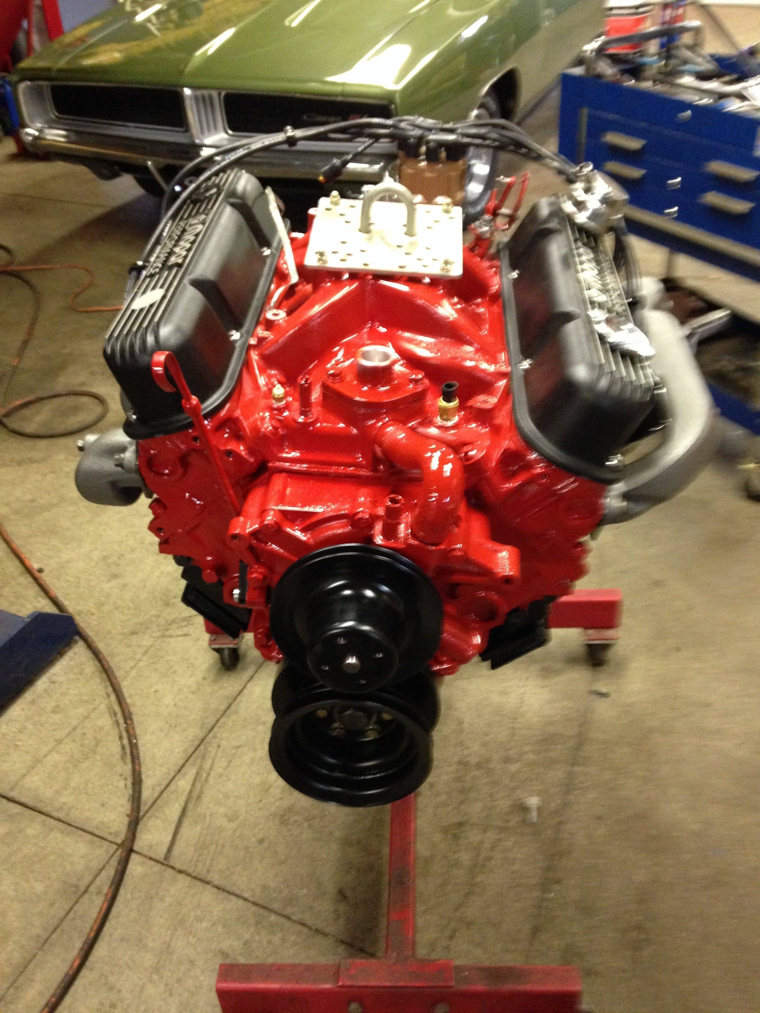

I used a good couple of coats of engine primer, my engine was bare metal. Then I used three cans of MP red for my 340 for my 68 Dart. I'll post some pics tomorrow.

Here is my engine ready to go in
