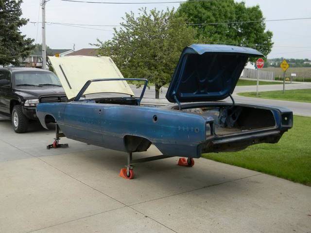

68 GT convertible project

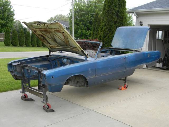

The car is ready for the body shop. I spent the day cleaning up the oil from the engine compartment and floor pans.(leaking top cylinder) I scraped out all the seam sealer from inside the trunk and blew out a lot of dirt from between the rockers and quarter panels.(it was completely filled with dirt in there) Then I power washed the entire car. It took a lot of water to clean out the dirt but the rocker pinch weld drains are now clear.

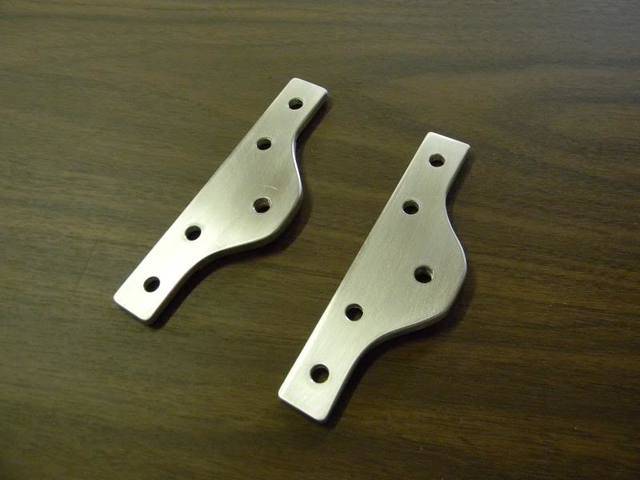

The brackets to mount the fender braces are done as well.

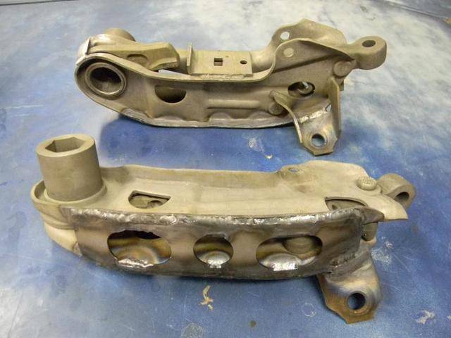

I bought reinforcement plates from Mancini Racing and had a friend install them for me yesterday afternoon. I also had him add welds to the sway bar bracket. We also clamped the torsion bar end together and welded on a small strap to keep the two halves together. Now they will be going to the poweder coater.

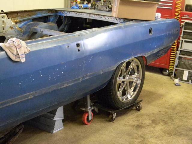

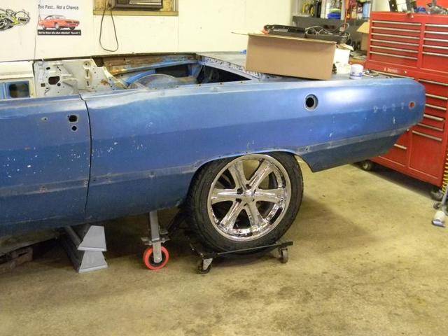

Today I grabbed one of the 20" wheels from my Durango out of the shed and put it under the Dart just to see what it would look like. The width is perfect. It's a 265-50 tire. There is about 5/8" on either side of the wheelwell. The tire is WAY too tall though. The tire is almost hitting wheelwell in the front and back. The backspacing is also way too much. At least it gives me an idea what 20's will look like back there.

Make sure your powder coater outgasses those LCAs before they get coated. Welding introduces a lot of air (and sometimes impurities depending on whether it was flux core / gas) which can and will blow out right through the powder.

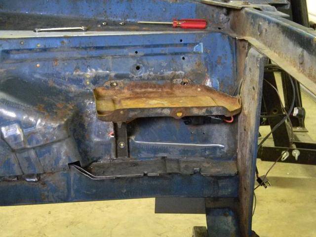

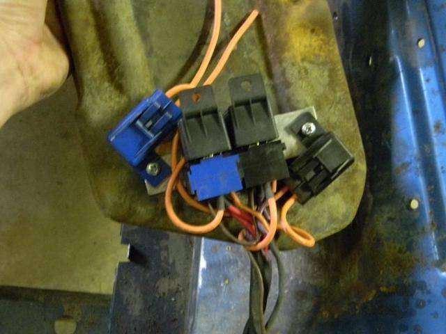

My headlight relay kit arrived yesterday so I thought I'd get it mocked up. I first mounted it to the inner fender below the battery tray.
I set the tray in place but the relays were too visible. I wanted them to be hidden more. I was thinking of making a cover to hide the area.
Today I moved the relays and mounted them to the underside of the tray.
With everything else in the engine compartment, you shouldn't see them at all. I'm also going to mount a bus bar under the tray to pick up power.

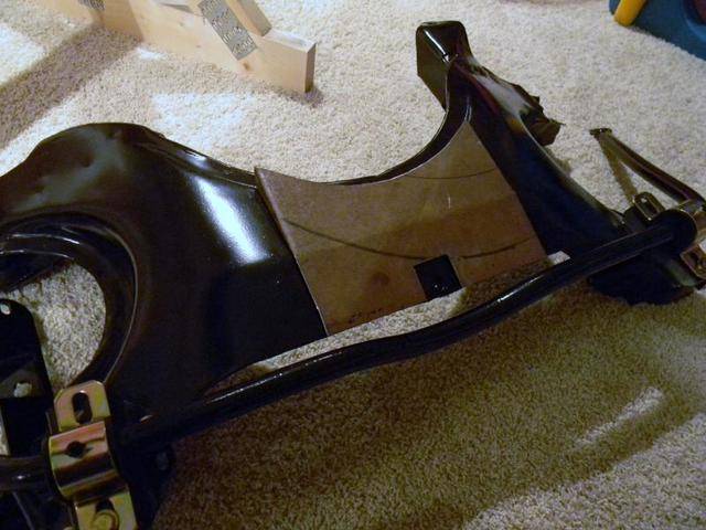

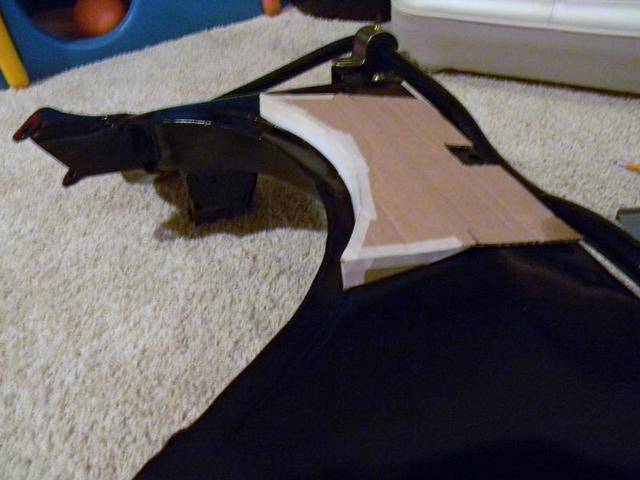

I was a little quick to get the K-member powder coated. I need to do some mods to it which will require it to be recoated. The torque strap I bought is supposed to be bolted to the pinch weld lip of the K. The lip on this K isn't wide enough though. There isn't enough meat on the lip to drill the holes. I was going to widen the lip but decided to just have the bracket welded onto the K instead.
I'm also adding a skid plate to the bottom. I made one out of cardboard to see what it would look like first.
I wasn't sure how to do the curved part. I thought about pie cutting the lip and bending each section down but decided against it. I just cut a strip of metal and bent it into a curve. The strip will be welded on the edge of the plate.

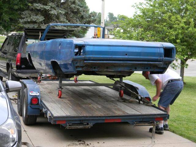

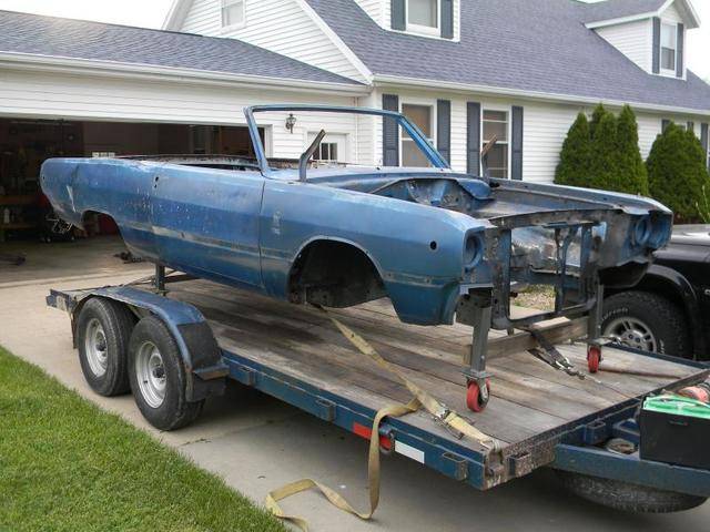

Well, it's at the body shop. We will see what it looks like after blasting. Hopefully I'll know what I need to buy before Carlisle.

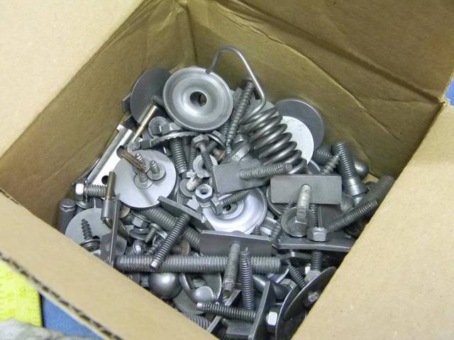

For cleaning up the fasteners, I use muriatic acid. It's sold as a pool cleaner at my local Ace Hardware. For $8 a gallon it's a lot less expensive than EvapoRust. It is more harmful to the parts though. It not only attacks the rust...it also attacks the good metal.(it attacks the rust much faster then the good metal though) The good thing about the acid is that it doesn't lose its strength and it will remove old zinc plating.
All these pieces were old and nasty looking. Some were rusted...others had nasty old zinc on them. A bath in the acid cleaned them right up. No need to blast every little fastener to get them ready for replating.
Just be aware that you need to be careful around it. Don't use it inside the garage. Use it outside. Where goggles and gloves. You also need to neutralize the acid or the parts will continue to rust and corrode. I neutralize my fasteners in baking soda water. I've also found that if you dip the parts in EvapoRust after the acid, they will stay rust free for a long time. The parts will start flash rusting immediately after they come out of the acid. These parts sat on my kitchen counter for over two weeks and never rusted.

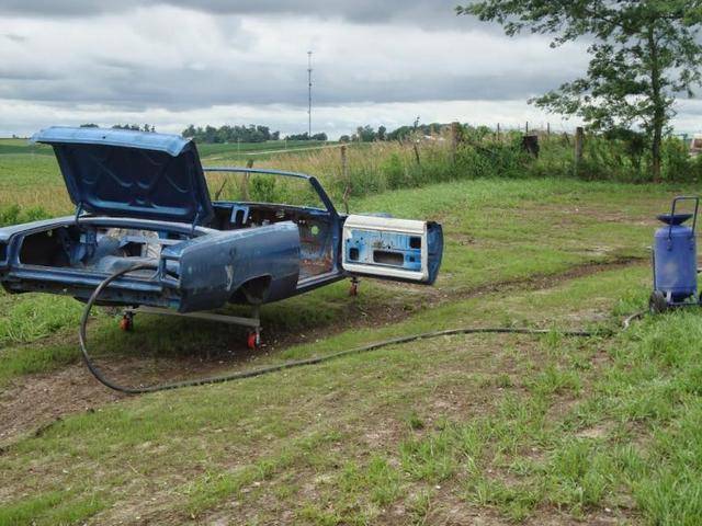

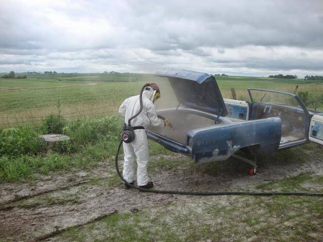

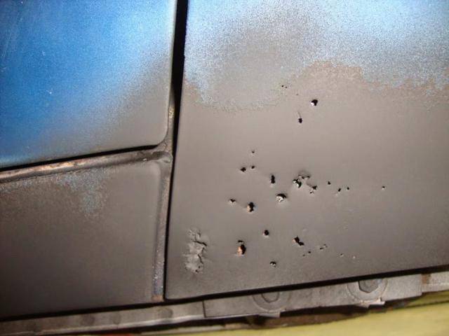

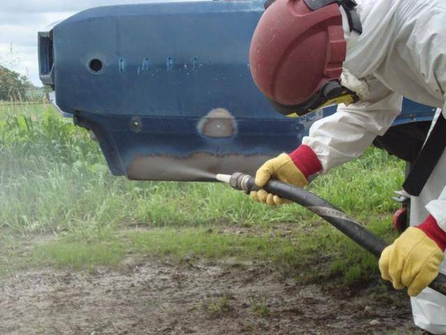

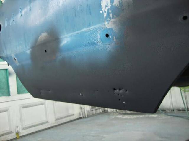

The car got blasted yesterday. It doesn't look like the front end or underside got touched yet though. Just enough was blasted so I can see what panels I need to replace. I'm going over there tomorrow morning to check it out and discuss things. From what I can see, there isn't anything that I didn't know about.
Darren,
Your right on, it is pretty much the norm condition for a vert. The floor pans look really good though, I had to replace the driver pan and a small patch on the passenger pan. Chances are the trunk pan to quarter sections will need replacing also, all norm...

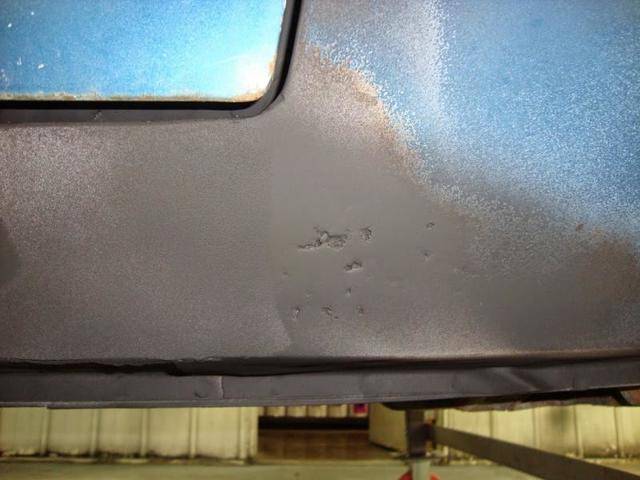

Went and checked out the car this morning. The floor has a few pin holes but we aren't going to put a whole floor in. The pin holes will be patched. I do need to find some replacement wiring covers. They are available new but they are priced ridiculously high for what they are. Hopefully I can find some nice ones from a parts car.
The quarters are also going to be patched. The area behind the wheels is the only rusty spot. The wheel arches and even the trunk drop-offs are good. I'll pic up some repair patches at Carlisle. The center of the PS quarter will need a lot of work but it isn't rusty so we are keeping it.
The trunk is mint. Not even any pin holes in the spare tire well.
