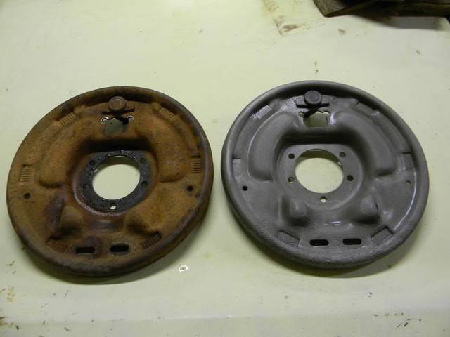

I started working on cleaning up the backing plates that came on the 8 3/4 I got. Unfortunately, they aren't in very good shape. I don't think I want to use them. It might not be that much more money to put a rear disc kit on the car by the time I get new backing plates, drums, shoes, wheel cylinders, hardware and spring kits.
The plate on the right is heavily pitted on the bottom. I cleaned up the left one tonight and the inside is very rough. A few of the contact pads are almost eaten completely away.

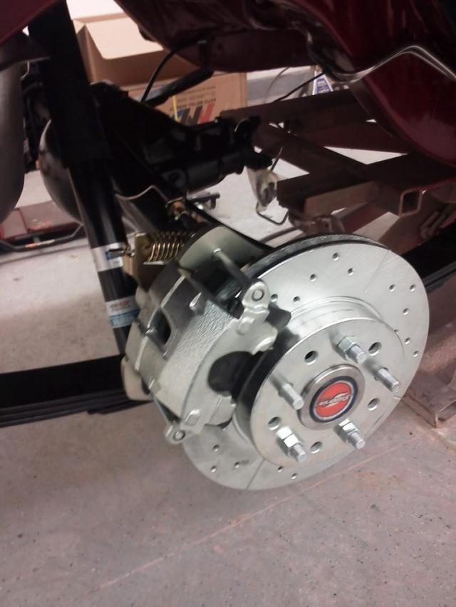

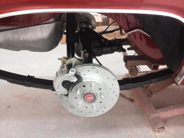

Here is the Dr Diff rear disc setup awesome fit, I may have a front disc setup from a 73 duster, if you are going to big bolt pattern!
I've heard the 73+ setup increases the front track. I want to get the front as low as possible and I'm afraid I'll need all the clearance I can get. Besides, the KH's just look so cool. I was going to run the Mustang rotors to get the BBP.

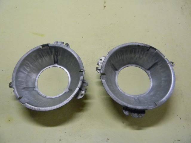

The headlight buckets cleaned up nice. A 20 minute soak in EvapoRust and a light buff with 0000 steel wool did the trick.

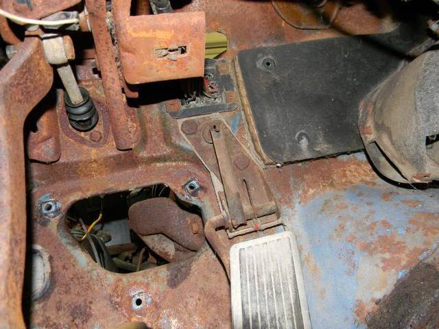

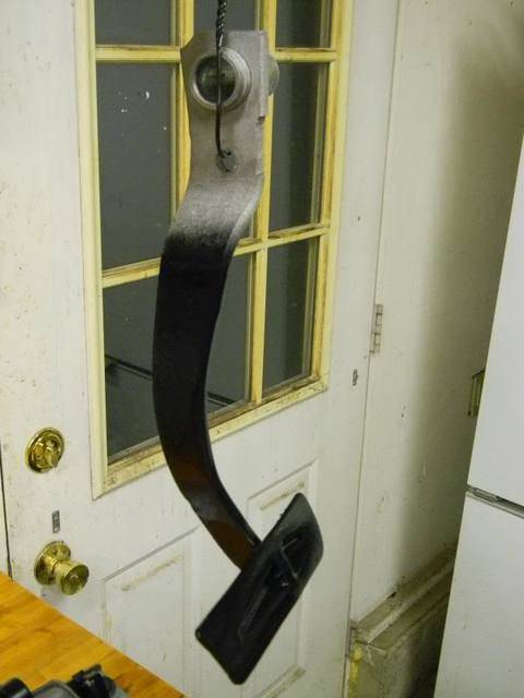

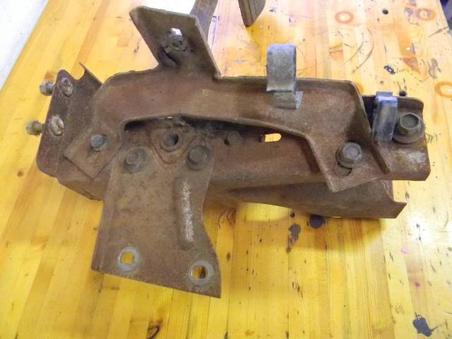

I'm not sure exactly what you call this...brake pedal assembly, steering column mount...but I cleaned it up tonight. A soak in muriatic acid cleaned it right up. Then I coated it with RPM so it won't rust. There are a few pieces that need to get zinc plated so those will get set aside for now. The brake pedal needs to finish drying before I RPM the pivot end.

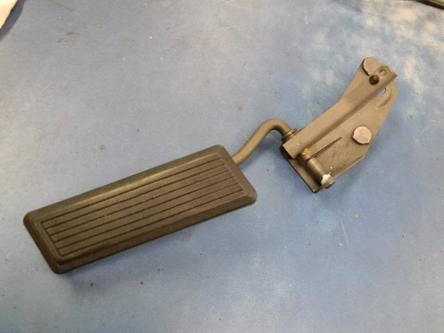

I cleaned up the gas pedal assembly. I thought I had a before picture of it off the car but I don't.
The end was rubber dipped to protect the plastic gas pedal so I reapplied some.

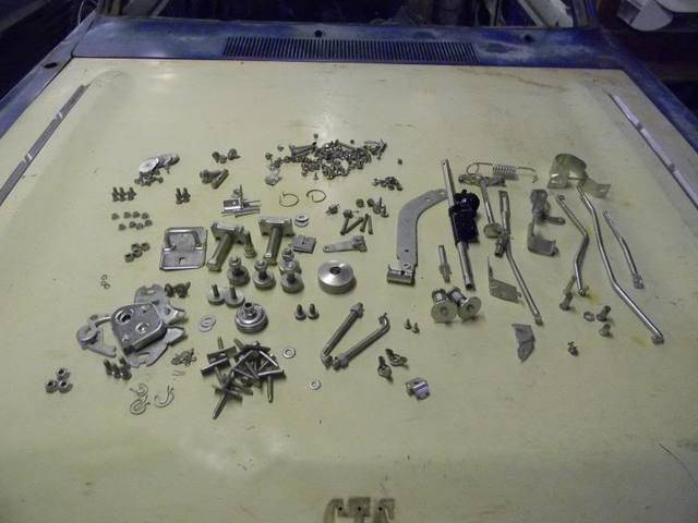

I've got most of the zinc fasteners stripped and ready to be re-plated. I still need to strip some engine fasteners as well as the coil bracket and kick-down linkage.

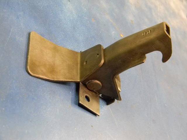

Here's a before and after of the hood latch. I'd like to send these out to be profetionally done but I have to save money where I can. The after picture didn't turn out very nice but they look good in person. They have a slight brownish look to them.
safety hook...

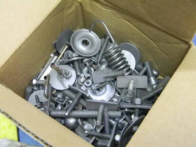

I picked up the zinc fasteners yesterday and I'm not happy. When I picked them up, the guy said "These are going to have a little yellowish look to them because our solution is stronger. It resists a 100 hour salt spray vs the normal 40 hour spray."
Some things will be OK. I'm not going back stock with this thing anyway...but some things in the engine comp are going to look like crap next to other things I have planned. I sorted everything out today so I didn't forget where anything goes and I'll deal with the engine comp stuff later. You can really tell the difference when you hold a silver zinc part up to them.
