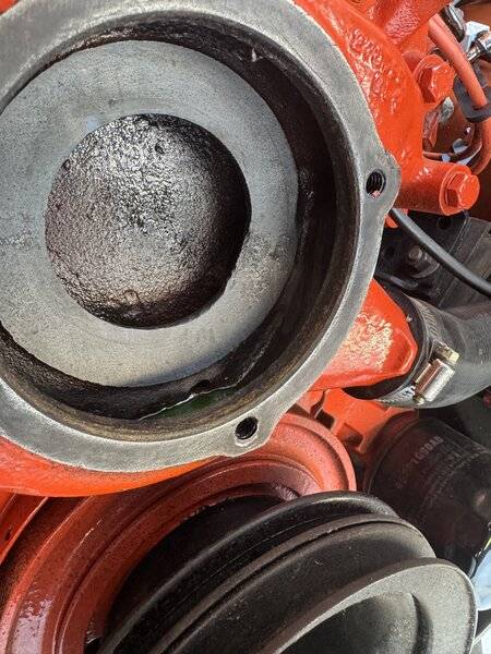

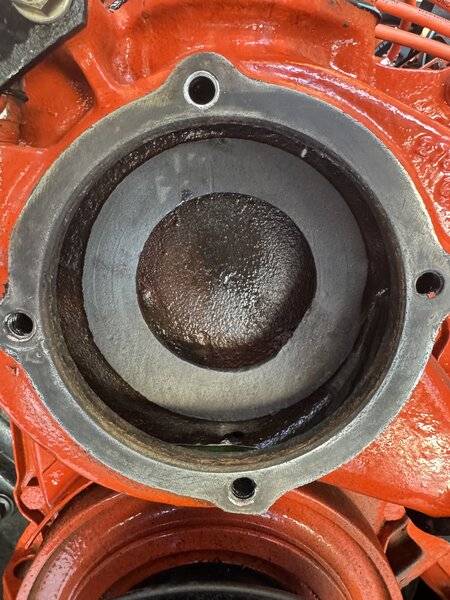

The engine did have stop leak put in it to fix an exhaust bolt leak on the passenger side. I am now pretty confident that the problem is a blockage issue now though. I have never seen this much junk in the radiator before, I would guess the new pump stirred a lot of crap up. There’s a whole mountain of sand in the radiator, and I took the radiator out and reverse flushed it three or four days ago, so this is all from just a few miles of driving.

The engine did have stop leak put in it to fix an exhaust bolt leak on the passenger side. I am now pretty confident that the problem is a blockage issue now though. I have never seen this much junk in the radiator before, I would guess the new pump stirred a lot of crap up. There’s a whole mountain of sand in the radiator, and I took the radiator out and reverse flushed it three or four days ago, so this is all from just a few miles of driving. View attachment 1716437699
That stop leak is some nasty stuff. I spent hours flushing out a 440 bare block on an engine stand with all of the core plugs removed. Had to use hooked wires and roll the block at different angles to dig all of the debris out. It will be tough to get this block clean while still in the car. I'm sure that there are pockets/passages in the block that are plugged solid.

With that amount of sediment I'll bet that there are hot spots in the block/heads that aren't getting good coolant flow
