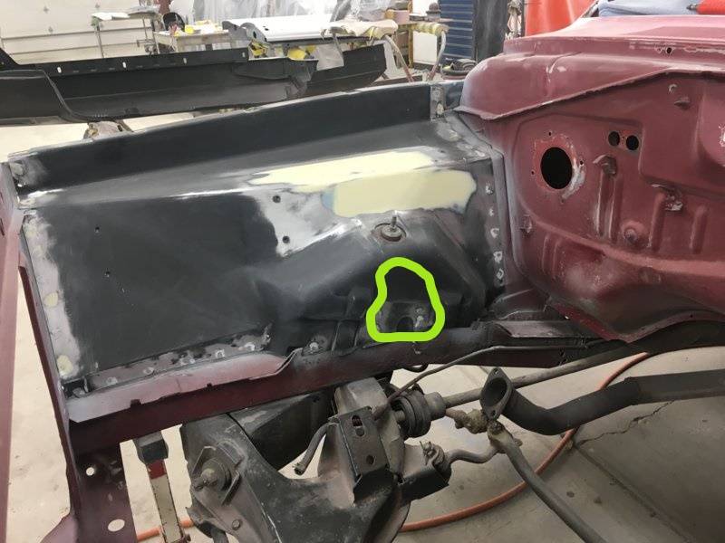

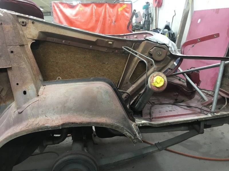

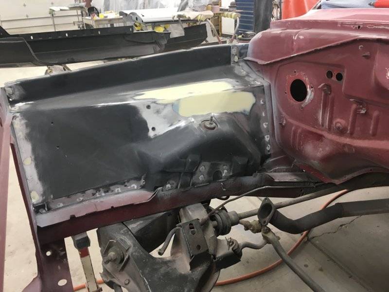

Using your photo... My question is I have some rot in the area with the green circle. Can I cut that out and replace with a piece of new metal??? THx
It depends on how bad the rust is under the inner fender. There are 3 layers of steel. Inner fender, upper control arm bracket and then the shock tower. I had to cut out and replace a piece of the UCA bracket after I got the inner fender off. jim
