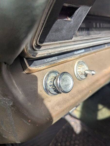

from the manual "remove the knob by depressing the release button on the switch and pull the knob out. After removing the bezel with Tool C-3824, lower the switch and disconnect the multiple connector." (8-75)
Reading the manual, it sounds like I need to remove that round bezel to pull the switch out from the dash. I'm not sure what it means by "remove knob by depressing the release button...."
The release button is either on the top or side of the headlight switch. So you're going to have to reach under the dash and feel for it. It's a small, spring loaded button. But here's the trick. You have to pull the headlight switch out FIRST and then push the button and pull the knob out. Then, yes, you have to unscrew the bezel and then remove the switch.
Is there a method or tool everyone uses to remove that bezel without damaging it? Other than the one listed.
edit: spoke too soon, I think I get it
I just use a screwdriver and small hammer, if you take it easy it will loosen and you can screw the rest of it out by hand...

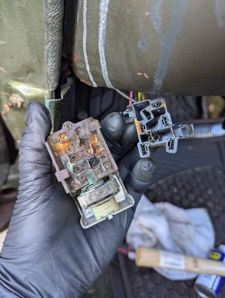

No and last I knew those switches should be available through "real" auto parts stores. And I agree, you better find out where the water came from
all the weatherstripping is in SERIOUS need of replacement. Going to start on that next.
As mentioned make sure to chk dimmer switch. I had 4 harness and everyone had a melted dimmer switch connector. Water from shoes/boots pools down there.
Got it off! Looks rough
Glad you got it all functional.
The plastic part is reproduced, saw one recently.
If not put a wanted ad and some one will have a good used one.
My 67 dart had the same issue.
I cleaned up the switch contacts and replaced the plastic and tightened the terminals.
All good now
