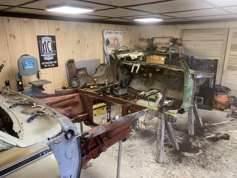

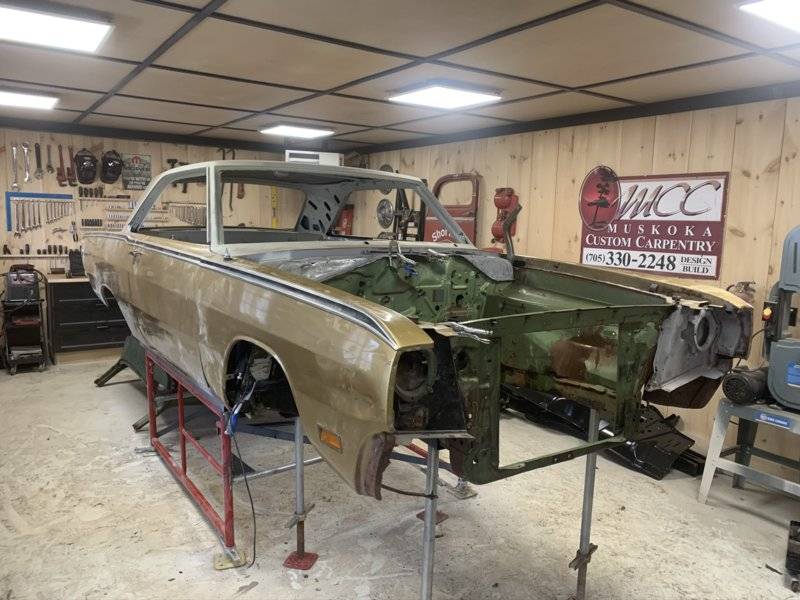

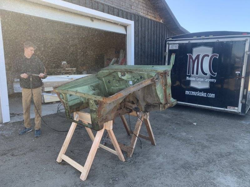

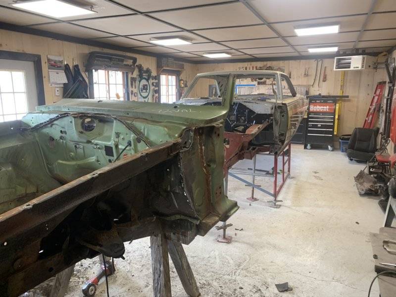

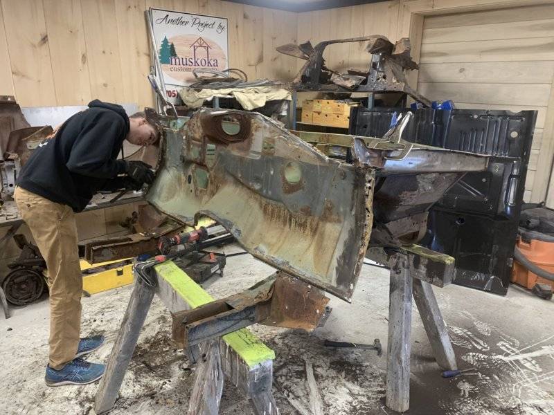

Went shopping for a front left frame rail and inner fenders (just needed the top flanges) and came home with this deal. Left frame rails seem to be impossible to find....this new front clip has a small hole in the left frame rail but it’s in a spot we can graft a chunk from one of our rights and be as good as new!

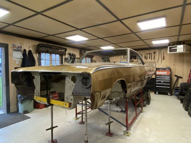

Next comes the daunting task of getting everything in the right spot!!!
Looks great so far. Dont forget to reuse your upper radiator support crossbeam from the 69 dart, that has the vin number last 8 digits stamped on it. If the scamp cowl panel and plenum are in better shape rust wise than the dart sheetmetal I'd use those pieces as well.
Yeah. The cowl is mint!!! Gonna swap that out once the firewall and frame is secured.

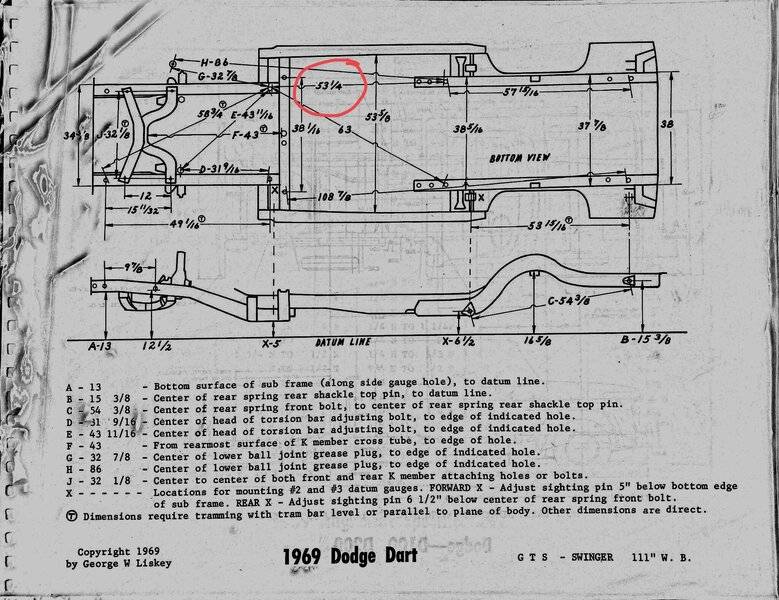

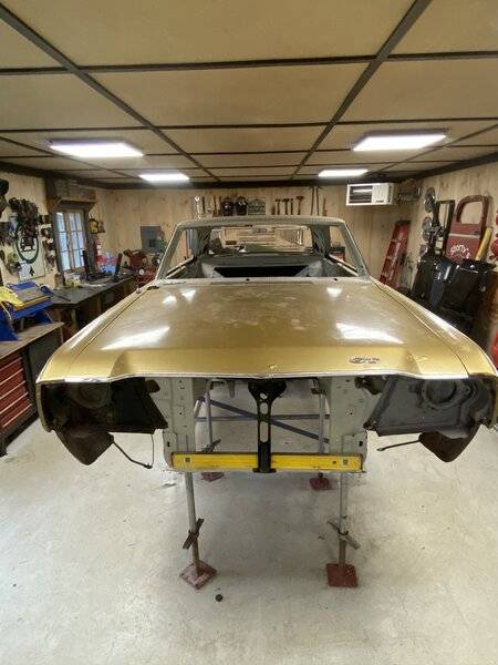

Found this on eBay. It’s way easier to use that the one in the mopar manual. We’ve got the new front clip mocked up and almost all the measurements check out....except the one circled in red. It’s 1/4” short. We put the hood and fenders back on and everything seems to fit really good...bit confused.

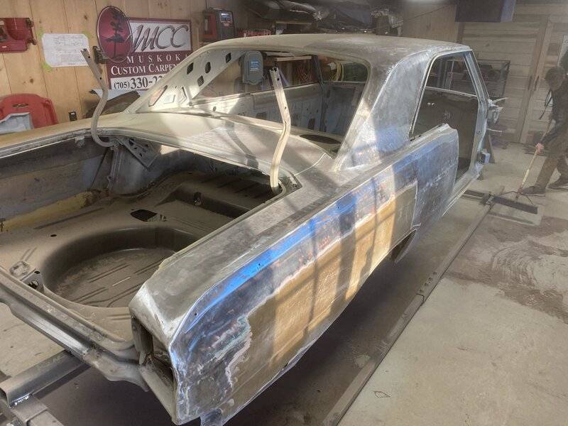

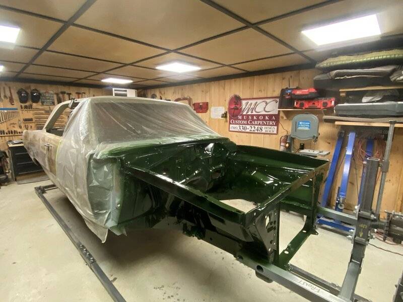

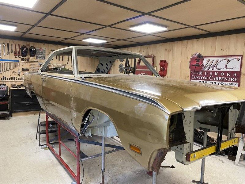

been plugging away during this crazy COVID. The boy has been doing great picking up on skills as we go!! Getting ready to replace both quarter panels and finish up couple more rust repairs and maybe get it painted and sitting on the floor!!!
Initial pics of that car it looked really decent, under side not.
I'm sure happy that it's working out for you guys, and BTW, I love the color!
